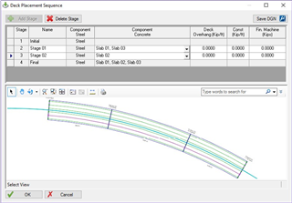

Deck Placement Sequence and Constructibility Analysis
The Deck Placement Sequence command allows previously defined slab segments (from the Deck Slab command) to be placed into the construction stages, which define the order in which the segments will be placed on the bare steel for the constructibility analysis.
By default there is always an Initial and Final stage. The Initial stage consists of the weight of the steel girders, cross frames and any other dead loads entered by the user that act on the non-composite steel section only. The Final Stage is treated separately from the construction stages and represents the fully assembled bridge, assuming the deck has been placed all at once on the steel.
