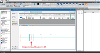

QUESTION: How to edit the pier location?
ANSWER:
To move the Pier or abutment in the transverse direction, please click on Pier/Abutment Locations” option.
Please check the option “Offset individual Support Locations” and then under Alignment offset please input the value and the program will move the support in transverse direction.
