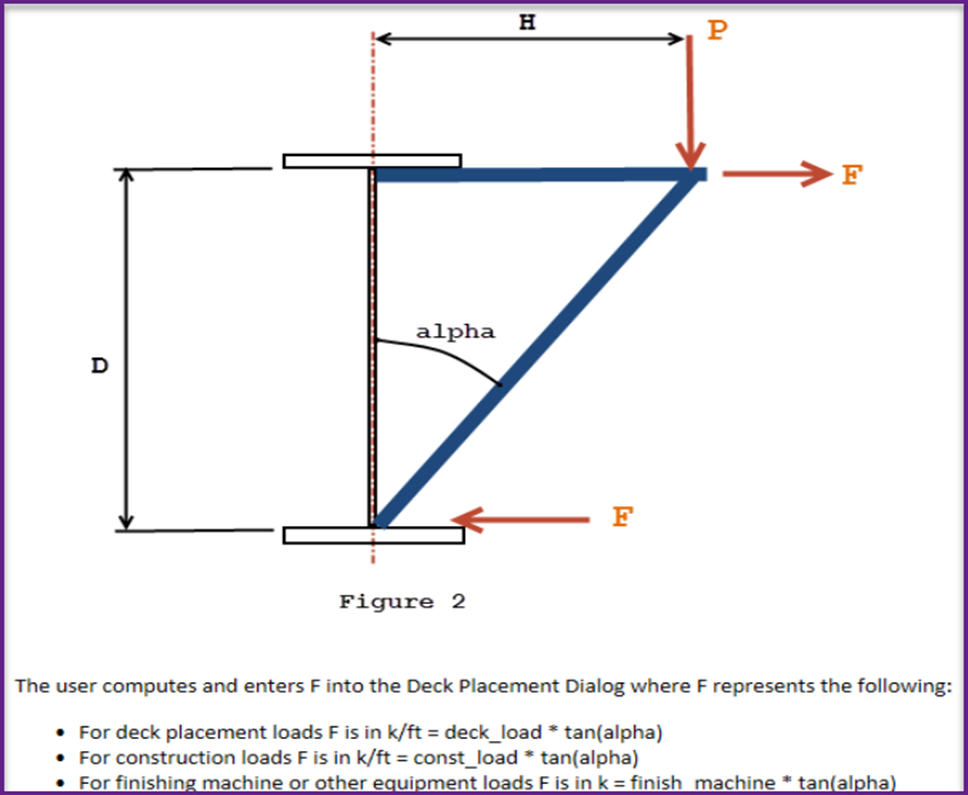

QUESTION: How is the Lateral flange bending stress fl calculation is performed?
ANSWER:

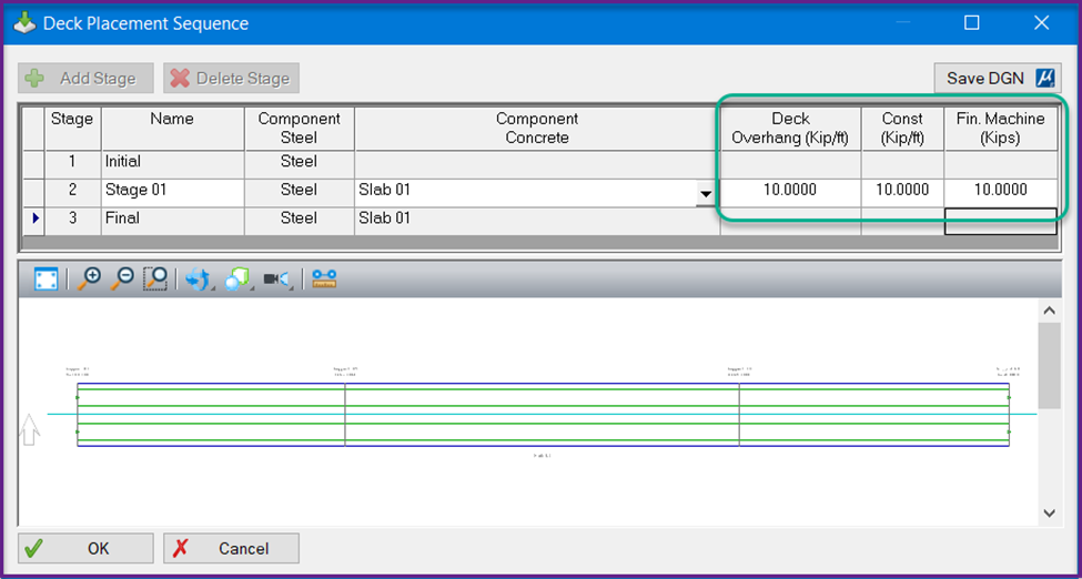

Deck, Construction and finishing machine loads is used to compute moments M_lat and that load/moment will be passed into the code checker with the appropriate factors applied based on the user selected Strength load combination.
For example -- The DC load factor is applied to the deck load and the DW load factor is applied to the construction loads and the finishing machine loads.
Calculation:
Lateral flange bending stress fl calculation:
For top flange fl_top = (Ml-deck + Ml-fin) / Sy-top-flange
For bottom flange fl_bot = (Ml-deck + Ml-fin) / Sy-bot-flange
