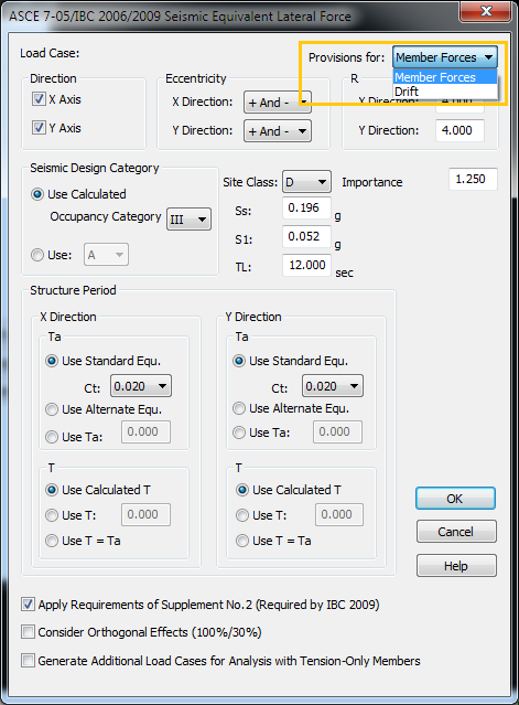

What is the difference between seismic loads that use provisions for member forces and provisions for drift?
When creating a seismic load case using the IBC/ASCE7 equivalent lateral force procedure, there is an option to use provision for member forces or provision for drift (see screenshot below).
The difference between these options is the upper limit of the calculated period used to calculate the seismic loads.  When provisions for member forces are used, an upper limit of T = CuTa is used for the calculated period per ASCE 7-05 12.8.2. When provisions for drift are used, the upper limit on the period is not used per ASCE 7-05 12.8.6.2

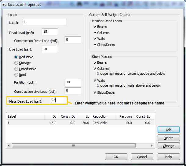

Do I need to divide the Mass DL by the acceleration of gravity?
No, the program is expecting a weight value for the "Mass DL"  despite the name. Enter the same magnitude as the dead load typically (or dead + some portion of the live depending on the live load type and code requirements - see [[RAMSS Gravity Loads FAQ]]). In the Ram Frame - Loads - Masses dialog the total weight and the equivalent mass of each level and diaphragm are reported for clarity.
On the Loads and Applied Forces report, the "Total Building Weight" is reported. This value is the sum of the Mass Dead Loads considered in the seismic analysis which can include member and deck self-weight. This is also a weight term, not a mass.
