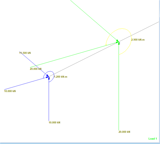

You need to use AddNodalLoad function to JOINT LOAD to the specified node number(s).
Along with function AddNodalLoad, you also need to use function SetLoadActive to make the load active

Sample VBA syntax:
' (The below syntax will assign nodal load(Fx,Fy,Fz,Mz) at Node 1 and Node 2 under Load Case 1)

LC = 1 'Load Case ID
objOpenSTAAD.Load.SetLoadActive LC
For i = 0 To 1
    objOpenSTAAD.Load.AddNodalLoad node(i), fx(i), fy(i), fz(i), mx(i), my(i), mz(i)
Next i

Sample output (VBA):
Sample output (python):
