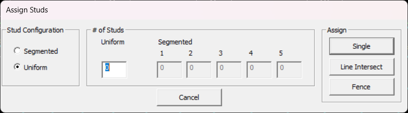

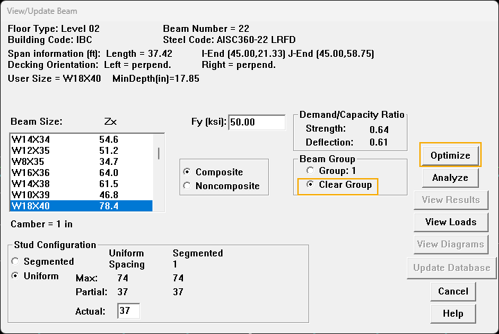

Using the Process - View/Update command, select the beam in the model. Change the selected member size, set the stud number to the desired value and click Analyze. Then click Update Database when finished.

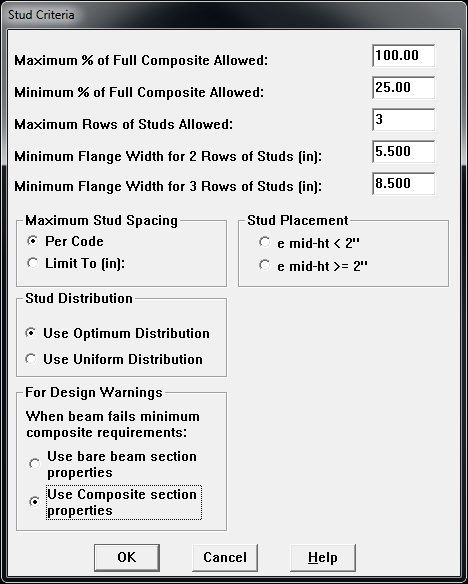

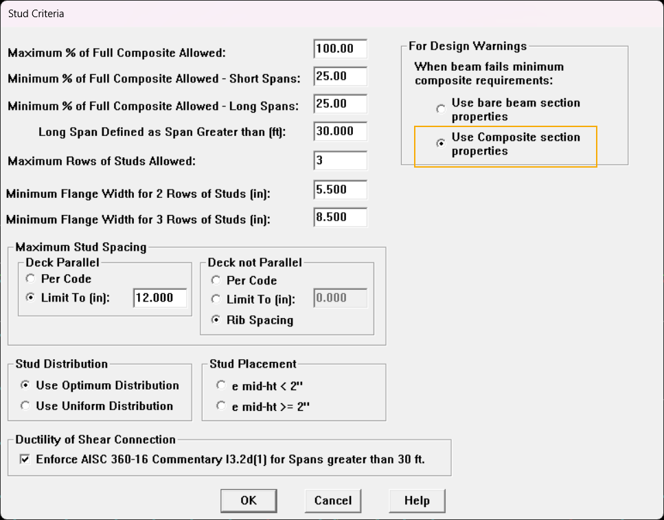

If the existing stud count is insufficient to achieve 25% composite action (or the code minimum), go to Criteria - Stud Criteria and for the last option, select to "Use Composite section properties".
Note: the program will never optimize a member with less than 25% composite action (US codes), but you can reduce the number of studs and evaluate this way.
The most common cause for composite beams that cannot achieve the minimum composite action is when the beam is acutely skewed to the angle of the deck. Thus, only a few flutes will cross the beam (or segment of the beam) limiting the total number of studs possible. Angles less than 15 degrees are treated as parallel to the beam, but the trigonometry of deck angles between 15 and 90 degrees to the beam are considered. In cases where the deck is to be split or crushed along a specific beam allowing for other spacing of studs, use the Assign - Ignore Rib Spacing command.

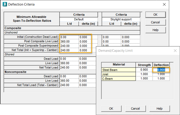

Yes, this was added in version 17.01 and after. Refer to the release notes under "User-specified Demand/Capacity Limits", or the program manual for details.
In prior versions this was not available for steel beams, only for open web steel joists. Previously for steel beams, the best thing to do is visually inspect the interaction colors and identify any beams that are too close to the max interaction ratio for your comfort and then Update those one-by-one.
Another alternative was to pad the loads slightly or reduce the beam Fy, run the design and freeze all beams, then reset the loads and run it again. This approach would effectively over design the beams not only for strength, but for deflection as well.

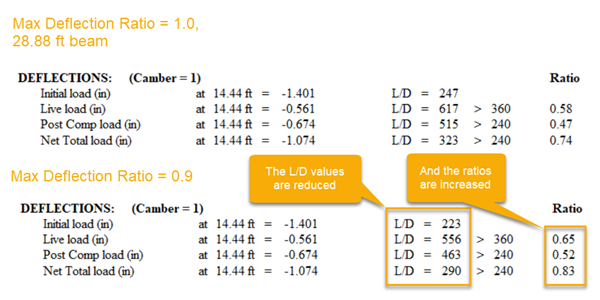

Note, in version 17.03, the deflection ratio values, "L/D" were adjusted to incorporate the user defined deflection Demand/Capacity limits. As an example, this 28.88 ft (347") beam is originally shown with L/D default limits of 360 and 240 and with a 1.0 Max deflection ratio specified. The second section is for the same beam, but with a 0.9 Demand/Capacity Deflection limit specified.
Here are the two criteria used in the latter part of the image above:

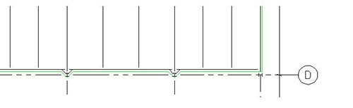

Opening or exposed beam: A beam that spans through an opening or penetration or for which there is a portion supporting no deck, such as an inset beam, will be designed as non-composite. Some times it is desired to design inset beams as composite. In order to do this, you can add a short beam from the column to the perimeter beams at an angle (say 45 degrees). Then define the slab edge so that it follows along these short beams, going out and around the perimeter column. That way, the entire beam is covered by the deck and it can be designed as composite (see below).

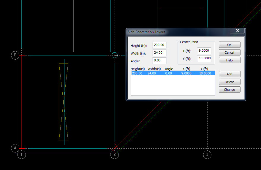

How can I limit the effective width considered for a composite beam.

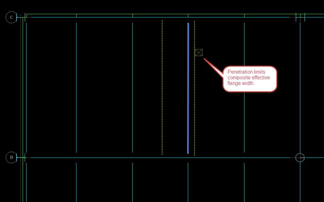

In composite design the program calculates the effective width (beff) automatically based on the geometry of the framing and decking. If you need to limit the width you can place a slab penetration on one or both sides of the beam in the Modeler. The size of the penetration does not matter since penetrations have no effect on the surface loading, so I recommend something fairly small, maybe 1' square, placed near the mid-span of the beam. The distance from the edge of the penetration to the beam center line will then be used for the effective flange width on that side.

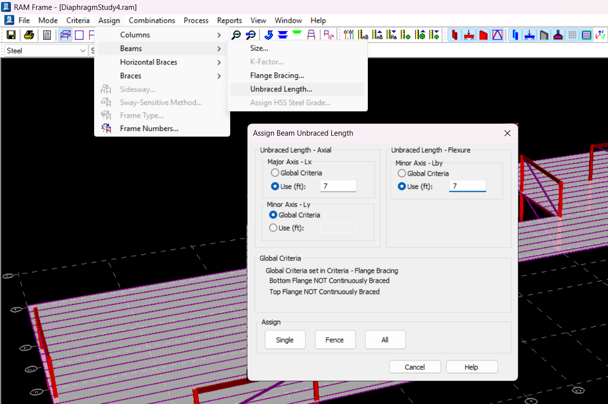

In cases where you want the unbraced length to be reduced you can add brace points in the Modeler using Layout - Beams - Brace points. Alternatively adding additional short beams framing into the beam in question will brace the top and bottom flange at those locations. Use joists where you want only the top flange braced.
In cases where you want the program to use a longer unbraced length, for example where a beam is set higher than the deck in reality, set the Criteria - Design Criteria - Unbraced length so that neither deck perpendicular nor parallel to the beam braces the top flange. Since it's a global criteria it will affect all beams, however, so you might have to set the criteria this way and check the one beam, freeze the design, and then check the rest using the preferred criteria.
