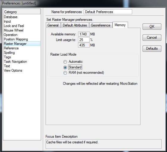

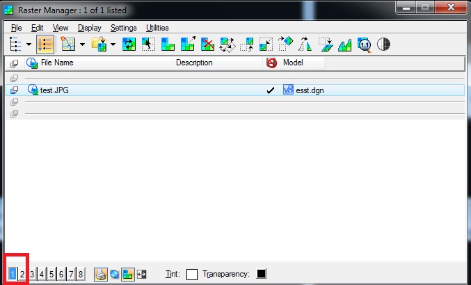

A Raster image has been attached through Raster Manager but it does not display.
Make sure that in Raster Manager the View in which Raster image is not displayed, is toggled:
Go into Workspace > Preference > Raster Manager > Memory change it from Automatic to Standard.
