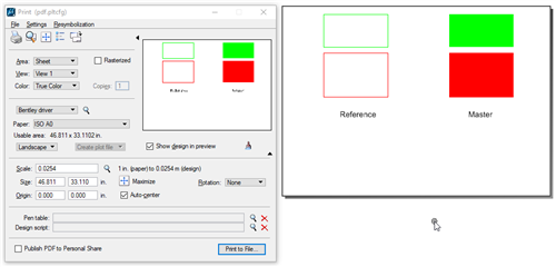

Having created a Sheet Model containing Reference(s) of which both contain Filled elements, when printing all Filled elements are printed. In certain situations, the Fill in the References is not required to be printed but the Fill in the Sheet Model is required.

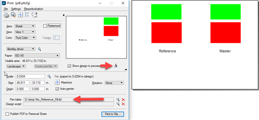

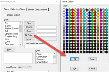

Option 2 Use a Pen Table to Re-symbolize the Filled elements in the Reference(s)
Using a Pen Table once created can be attached as required, will not affect the Design elements.
