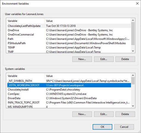

MicroStation does not load and the following message is displayed in the MicroStation text window.
_USTN_WORKSPACEROOT configuration variable is set to default in msconfig.cfg
Created a MSDEBUG log of the configuration and see _USTN_WORKSPACEROOT is redirected in the system environment level.
(system env): _USTN_WORKSPACEROOT=\\srv-001\Projects\workspace\ [\\srv-001\Projects\workspace\]
Removing this variable loads MicroStation.
