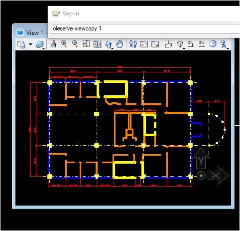

1) From the dgn file, set view of the desired elements
2) Key in: OLESERVE VIEWCOPY , then select view
           Or OLESERVE VIEWCOPY n ……where "n" is view number 1 or 2 …(e,g key in: OLESERVE VIEWCOPY 1)

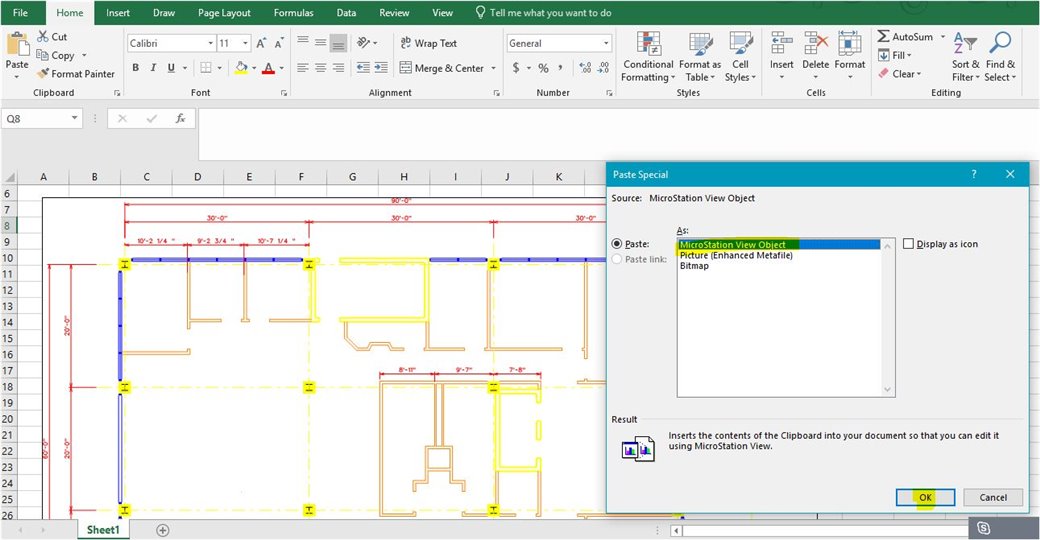

3) Next, open Microsoft Excel program , right click and Paste special, > Paste >MicroStation View Object
