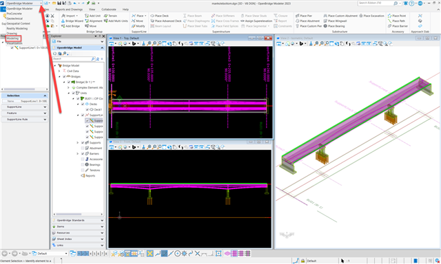

- Modify the Workflow to Modeling

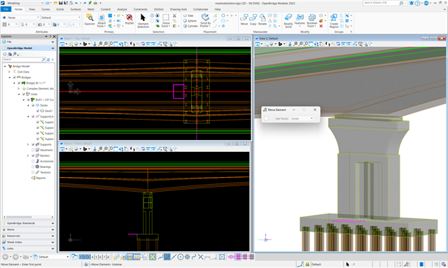

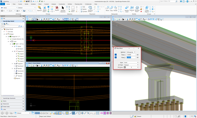

- At Placement use the Place Block button to create a rectangle
- From Manipulate, use the Move button to get it to a position close enough to define the cut

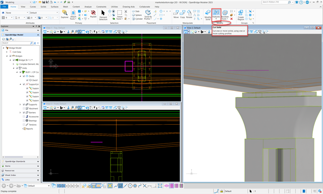

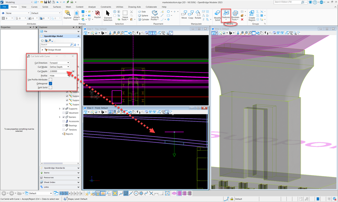

- From the Modify Tab, at the Features Ribbon, select the option Cut Solid and use the settings Forward and Define Depth
- To cut only the bottom flange enter the value as depth distance according to what is necessary in your case
- Select the rectangle block as the Cutting profile and the Deck as the Surface to be cut
- Check on the screen the Target solids as well as the Direction and Depth

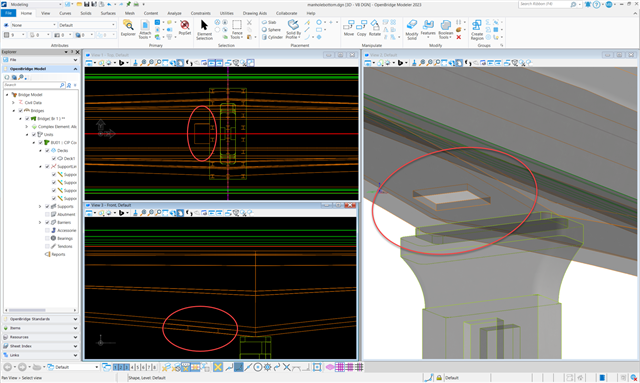

- Accept with a Data point
