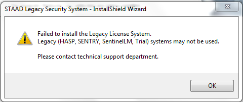

 Error or Warning Message
A message "Failed to install the Legacy License System. Legacy (HASP, SENTRY, SentinelLM, Trial) systems may not be used. Please contact technical support department." can be reported at the end of the installation of STAAD.Pro:
This usually happens if the product is being installed on the Windows7/8 operating systems.
In general, this message does not have any impact on the licensing of STAAD.Pro, as nowadays such licensing type is not used for STAAD.Pro anymore.
How to Avoid
In order to avoid this error message, the user has to run STAAD.Pro installation file (i.e. stpst20070931en.exe) as administrator (right click on the installation file and select option Run As Administrator).
