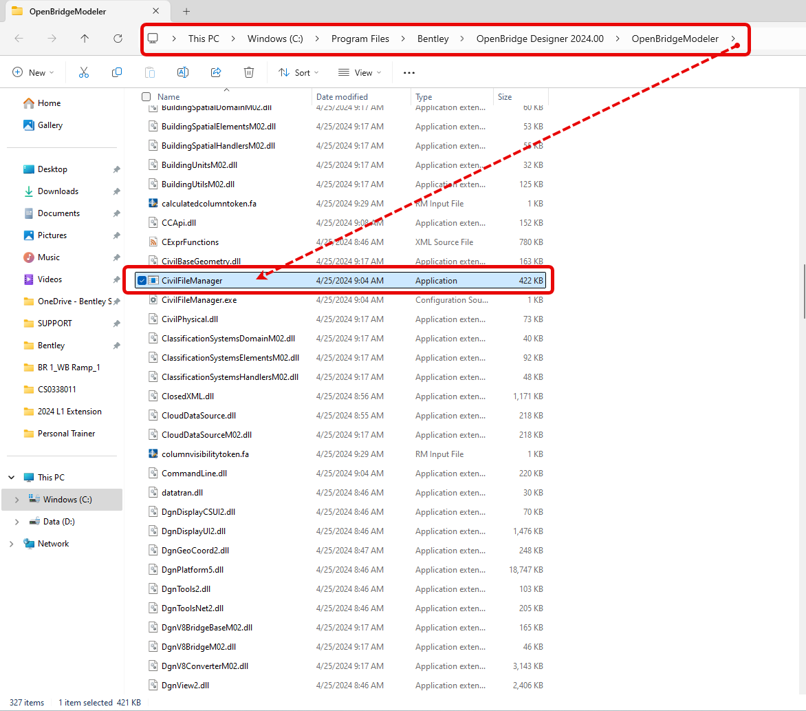

1. Users will find and be able to start the Civil File Manager from the selected installation folder of the current version of OpenBridge Modeler.

Search within the OBM installation folder for the Civil File Manager.exe executable file and double-click on it to execute.
After opening it by selecting the CFM from the OBM installation folder, the CFM is considered part of the current OBM version.

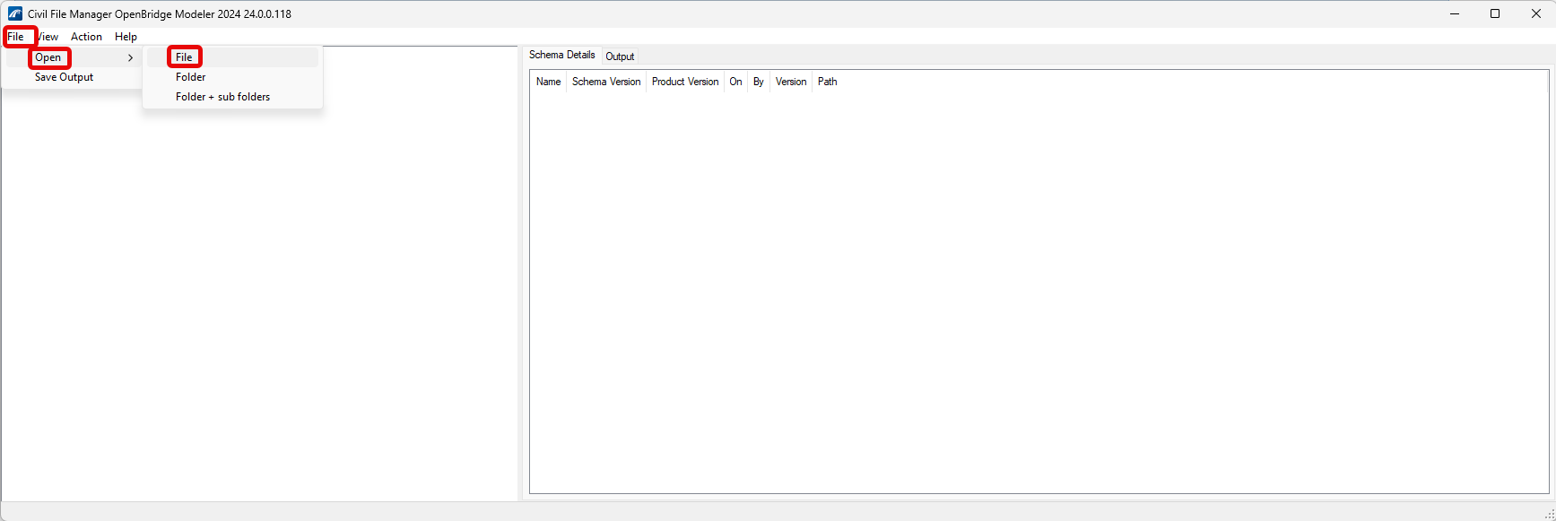

As highlighted in the image below, in the CFM, select File\Open\File.
Search for the folder and the specific file in which you want to analyze the data and schemas.

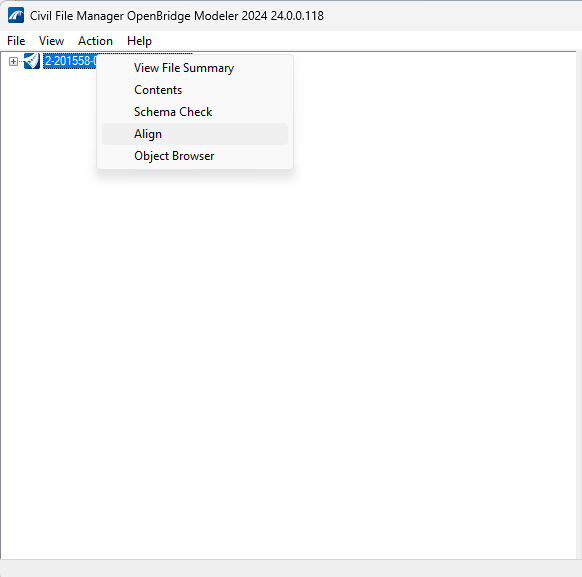

Select a File and the CFM will show the current Schema version, branding, and details.
Right-mouse-click over the filename and Select Align to align it to the current version.
The output details will show a message when the action is complete, or unsuccessful.
