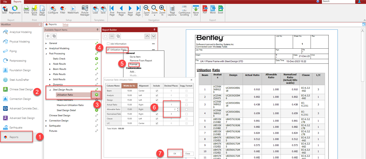

Is it possible to change the decimal places of utilization ratios in the Design Results table?
The decimal places of the utilization ratios cannot be changed in the GUI as of now. However, it is possible to change the decimal places of the utilization ratios in the new Reports workflow which was implemented in STAAD.Pro 2023. You may follow these steps:
1) Go to the Reports workflow;
2) Expand the Steel Design Results report item;
3) Click + sign next to the Utilization Ratio item to add the table into the Report Builder;
4) In the Report Builder, right click on the Utilization Ratio item;
5) Select Format option;
6) Set the required decimal places in the Decimal Places column;
7) Press OK.
