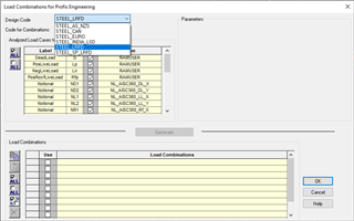

In the Load Combinations for PROFIS Engineering dialog select the desired Design Code:
The current options are AISC LRFD, AISC LRFD with Omega factored seismic forces (STEEL_SP_LRFD), Eurocode, Canada, Australia/New Zealand, and India LSD.

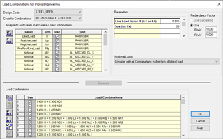

Select the desired Code for Combinations, specify the parameters and options as necessary, and Generate the Load Combinations:
Note that a large number of load combinations may have been generated. Often it is obvious which subset of those combinations is likely to control the design of the base plate; for efficiency it is recommended that the combinations that will obviously not control be unselected. The selection of combinations can be done either by selecting or deselecting the load combinations in the Use column in the Load Combinations for PROFIS Engineering dialog, or later in the Hilti PROFIS Engineering program itself. Note that for the free version of PROFIS Engineering the number of combinations is limited to 10.
Select OK.

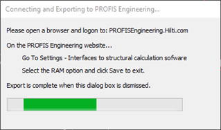

A message will appear indicating that the process of connecting to and exporting the data to the PROFIS Engineering program has been initiated:
From this point on you will be in the Hilti PROFIS Engineering program, with the data for the base plate design extracted and exported from the RAM Structural System. See the PROFIS Engineering documentation referenced above for information on the use of that program: PROFIS Engineering and RAM Structural System Step-by-Step Guide.
