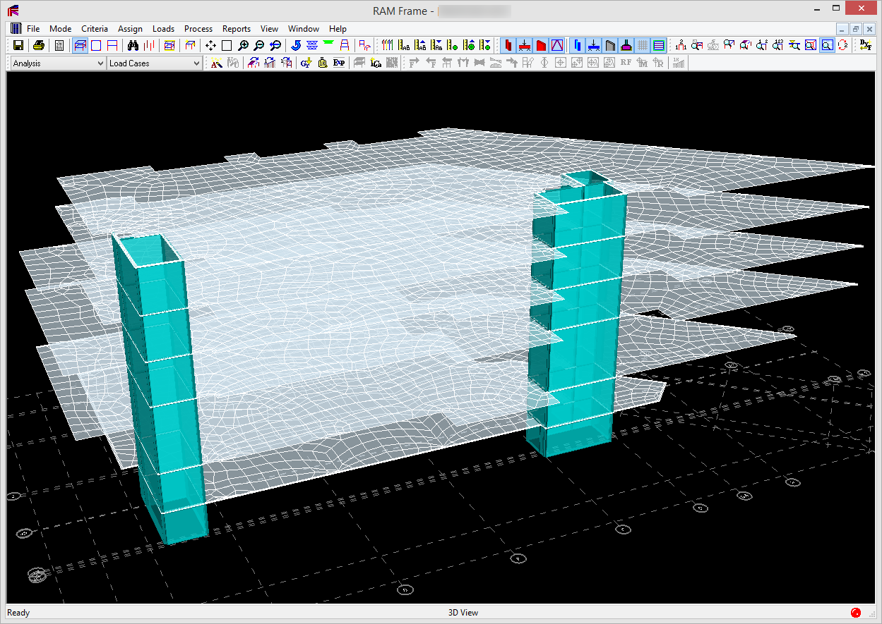

Lateral walls, 2-way decks and semi-rigid diaphragms are all composed of shell elements in Ram Frame Analysis and Ram Concrete. The subdivision of these elements into smaller pieces is commonly referred to as meshing. In Ram Frame, the size of the mesh is controlled by the “Maximum distance between nodes” parameter in Ram Frame – Criteria – General (also under Criteria - Diaphragm).
Furthermore, when a lateral beam has an internal node at a column or brace end, the member is segmented in the finite element model and represented by two segments. These finite element segments are denoted by the use of i’ and j’ in the member force results. The first segment ends are i and j’ and the second segment ends are i’ and j. Therefore, i’ and j’ are always the ends at the internal node.
Common Meshing and Segmentation Issues

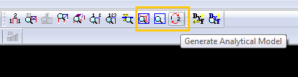

When two-way deck, semirigid diaphragms or lateral walls are present in the model, Ram Frame will go through a meshing process when you start the analysis. You can also start the meshing process by using the View - Meshed floors, View - Meshed walls or Generate Analytical Model tools.

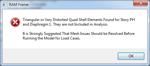

Triangular or Very Distorted Quad Shell Elements Found
This particular warning became more pronounced in version 15.04 as presented in the warning above. Prior versions listed such warnings in the meshing log only. A distorted mesh does not generally cause the program to malfunction, but the mesh of the deck (and walls) should be reviewed in these cases. Adjustments in the mesh size or other parameters set under Criteria - Diaphragm can sometimes resolve it.

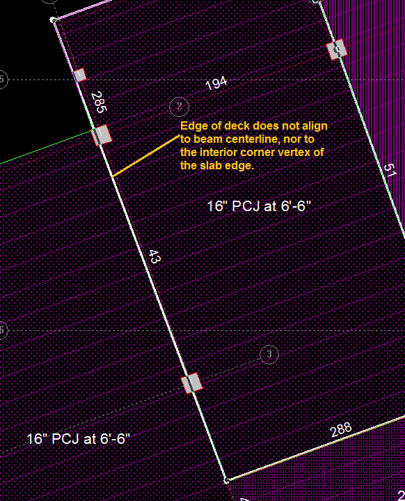

Deck Layout
Typically, these errors are related to the deck polygons (or occasionally the surface loads). Excessive overlapping polygons and subtle overlaps between polygons can cause problems for the program algorithms. Also, deck polygons that do not align with beam and wall center lines or do not extend to the slab edge will cause problems.
To diagnose these types of issues, in a copy of the model apply a deck to the entire floor. That will delete the existing polygons and should resolve the meshing issue. Then, carefully go back and remodel the partial polygons. Enter Ram Frame and generate the analytical model after each modification to make sure the problem has not returned.

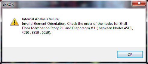

Invalid Element Orientation.
In some cases the semi-rigid diaphragm will mesh successfully but, on close examination, the nodes of the diaphragm will deviate vertically from the nodes of the frames or walls which will lead to a model instability.

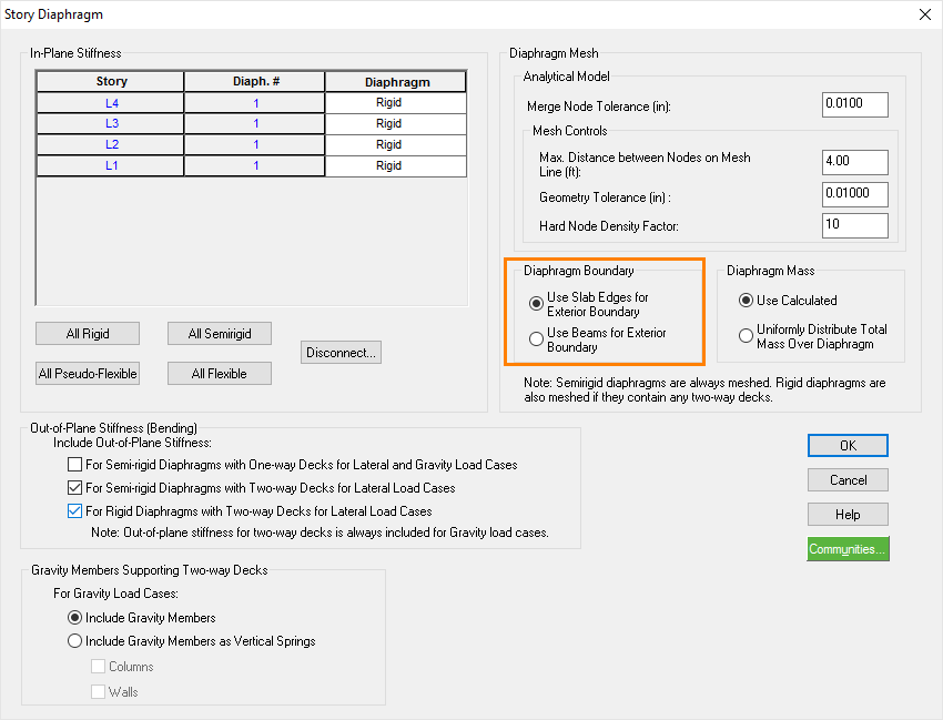

Perimeter Beams (framing) vs. Slab Edges for Diaphragm Exterior Boundary
When a structure has a complete perimeter of beams or walls the user can simplify the meshing of the diaphragm by terminating at the perimeter beam center line. This is controlled by the Criteria - Diaphragms - Diaphragm Boundary setting by using the second option. "Use Beams for Exterior Boundary". This is recommended for semi-rigid diaphragms with small slab edge overhangs in particular.
On the other hand, if the model is a free form, 2-way deck without a continuous perimeter then it's important to only use the first option, "Use Slab Edges for Exterior Boundary".

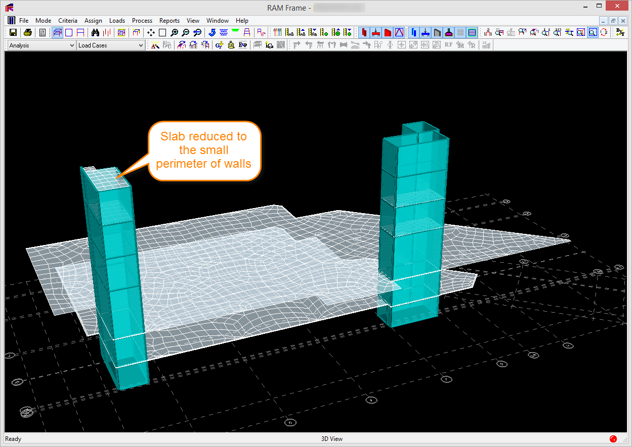

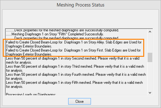

We have seen cases where a large slab might be clipped back to an interior elevator core only when the beams options is used. This generates a warning in the meshing dialog but that can be overlooked.
Example of a diaphragm that is properly meshed to the exterior slab edges
Example of a diaphragm that is excessively clipped to a small set of walls that define a "perimeter"
Regardless, always use the control View - Meshed Floors to visually inspect the resulting floor mesh before running the analysis.

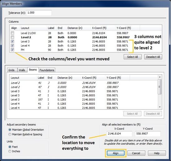

To resolve the issue, go to Ram Modeler and review the member end coordinates using the Layout – Show, or the Integrity - Align commands. Them move, align or replace the offending members being careful to snap to key points like grids.

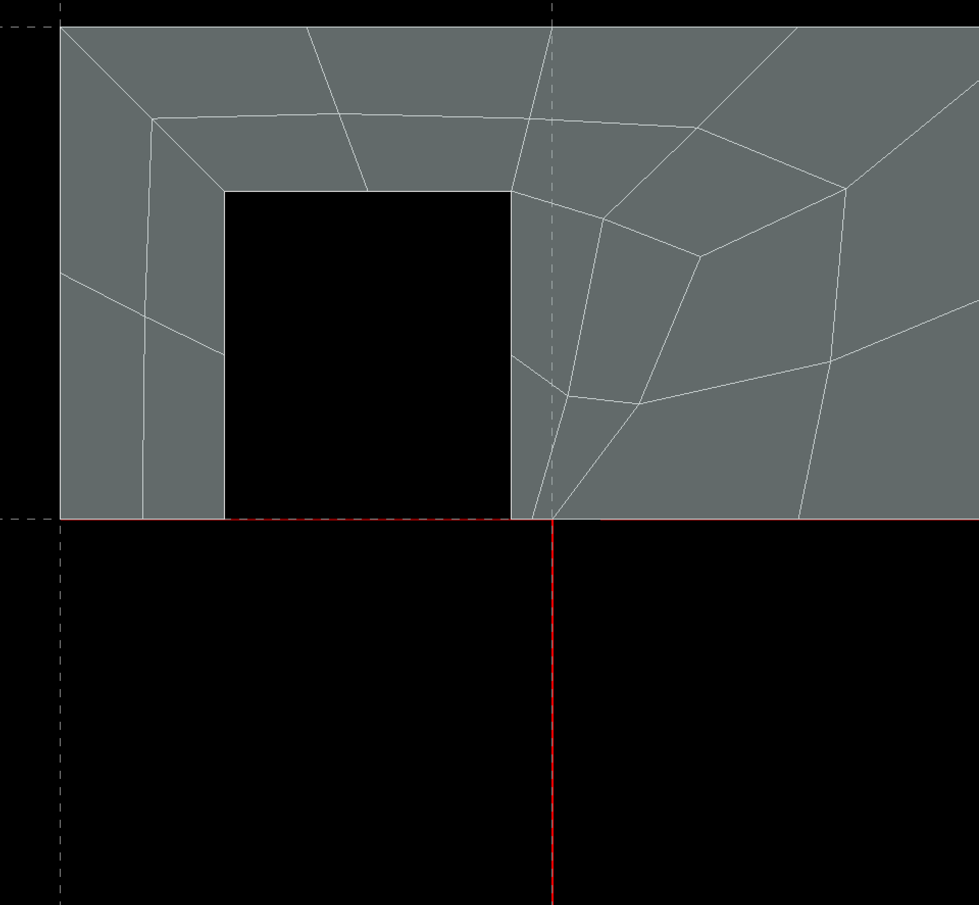

Wall Openings
A similar issue can occur with wall openings. If there is a thin sliver of wall between the edge of an opening and the edge of a wall, this will produce a poor mesh. Look for poor wall meshes by using Ram Frame – View – Meshed Walls. Modify the size of the opening in elevation mode in Ram Modeler so the opening aligns with the wall edge.

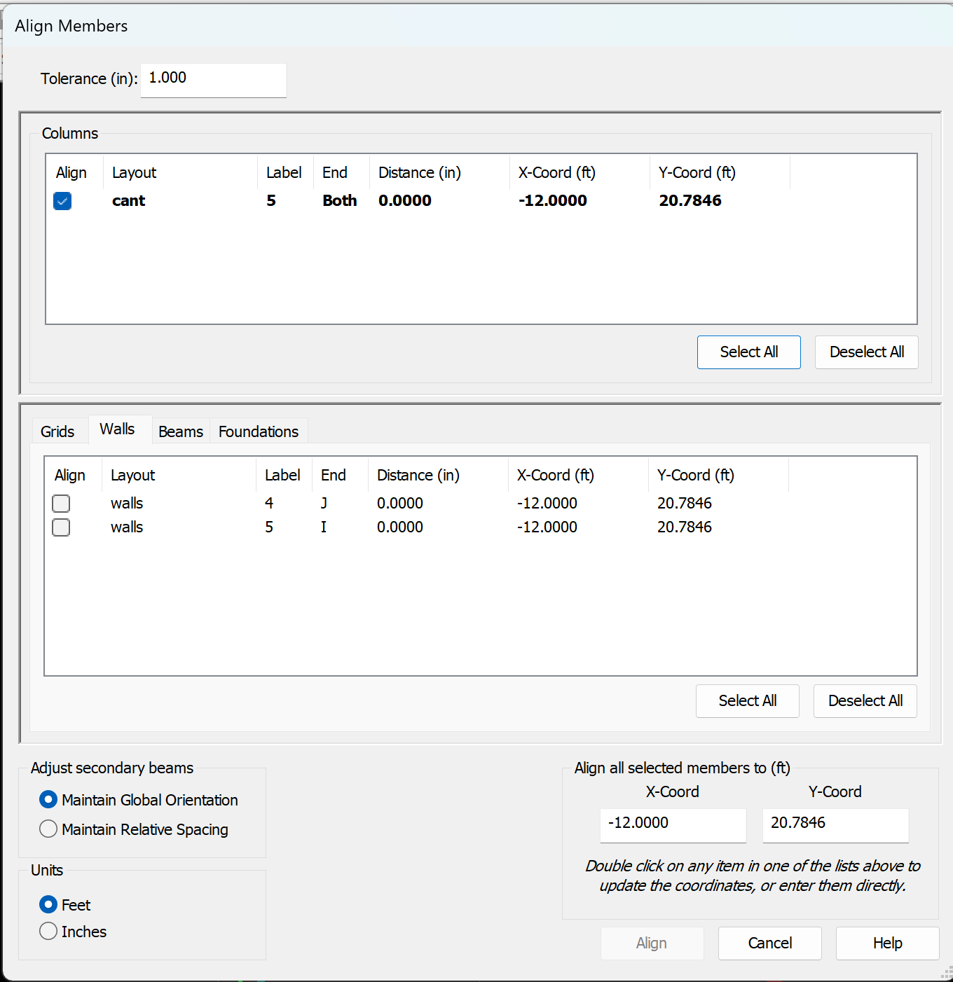

In the Modeler under the integrity menu are two powerful commands, Align Columns and Align walls. These tools allow you to reposition walls or columns on some or all levels so that they align through the height of the structure. The objects can be aligned to one another, or to a grid intersection or any user provided coordinate.
This is similar to moving grids. When the supports are moved all of the supported framing is also adjusted or stretched. Since this can have unexpected effects, it's always best to back up the file before using these adjustments.
Another tip is to use the Layout - Slab - Deck Assign - Change Polygon option so that you can stretch the corners of the deck polygons. The edge of deck polygons should typically align with beams or walls. Deck changes should not occur mid-bay except when using 2-way decks. At the edges of the structure it is fine for the decks to extend you to the slab edge vertices or even beyond, but in cases where the slope is complicated, it may be simpler to stop the deck at the perimeter framing. In these cases the program will assume a like type deck on the overhanging portion of the slab edge.
