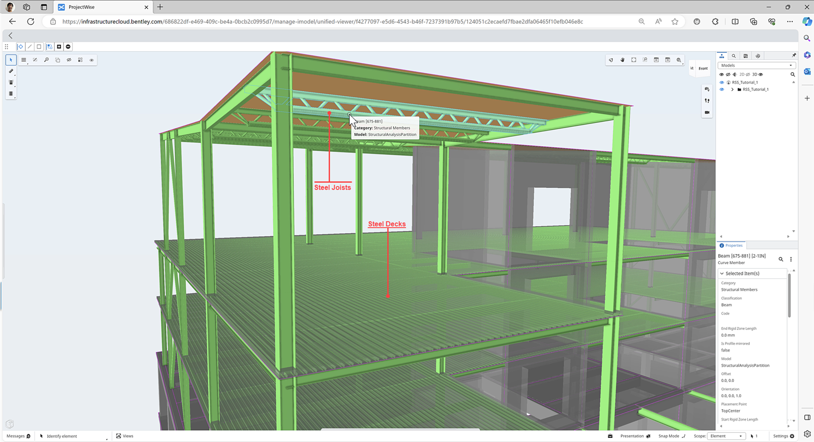

Bentley Infrastructure Cloud
Steel Decks and Joists are now fully supported on Bentley Infrastructure Cloud. This enhancement particularly benefits RAM Structural System users.

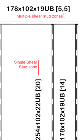

- Previously, shear stud values were inconsistently displayed, requiring rework to reconcile different display formats. They are now consistently displayed with square brackets for both beams with a single shear stud zone and beams with multiple shear stud zones. A comma delimited format is adopted for beams with multiple shear stud zones.

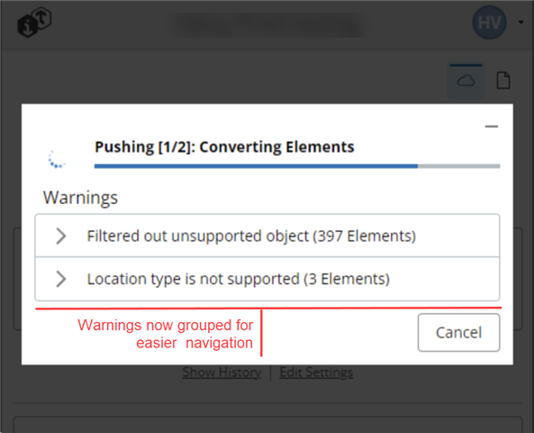

Cloud Synchronization
 Across all host application's in-product cloud synchronization operation, status messaging has been grouped and streamlined.

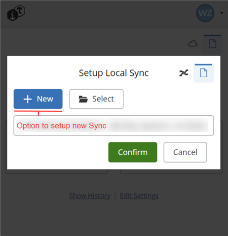

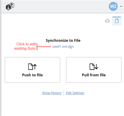

 Added ability to establish subsequent new Sync.
Once an existing sync is established, select or establish a new sync by clicking on the blue hyperlink:
Previously only the initial "push" provides the New Sync button, whereas now the New sync button is ever present.
