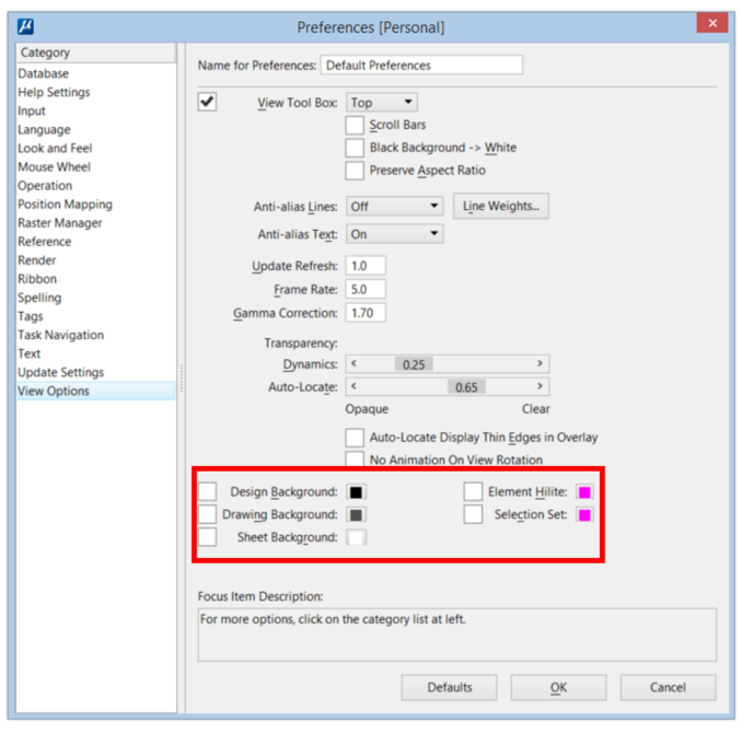

Did you know that you can control the color preferences for items such as your design model background color, your sheet model background color, and highlight colors?
_________________________________________________________________________________________
Color Preferences - New options have been added to the View Options category of the Preferences dialog that allow you to control the design model background color, sheet model background color, element highlight color and selection set color.
File>Settings>Preferences>View Options
