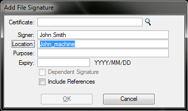

Option 1 Adding File Signature(You must have certificate for dignature signature installed)
  1. You must go to Workspace>Configuration>Protection and enable protection
  2. Go to Tools>Security>Digital>Open Toolbox
  3. Click on Add File Signature.
  4. Click on Browse button, this will open to location of where personal certificate store has the file stored on your machine
  5. (Optional) Enter the reason the file is being signed in the Purpose field.
  6. (Optional) Enter the date the signature expires in the Expiry field.
  7. (Optional) Click the Include References check box if you want the contents of all references attached to the master file to be included in the signature.
  8. Select certificate, Click OK. The new signature is annotated automatically with the current time from the
    signer´s machine.

Creating a Signing Hierarchy
 To create a hierarchy, the signer selects one or more existing signatures in the Digital Signatures dialog before activating the Add Model or File Signature tool. The signer then specifies that the new signature will depend on the selected signatures.
  1. From the Digital Signatures dialog, select one or more existing signatures.
  2. Select the Add File Signature (or Place Signature Cell) icon. The Add File Signature (or Place Signature Cell) dialog opens. The name of the signer and there location is filled in from the selection of the certificate.
  3. Select a certificate from your personal certificate store.
  4. Click the Dependent Signature check box if you want to create a signature hierarchy.
  5. Click OK.
