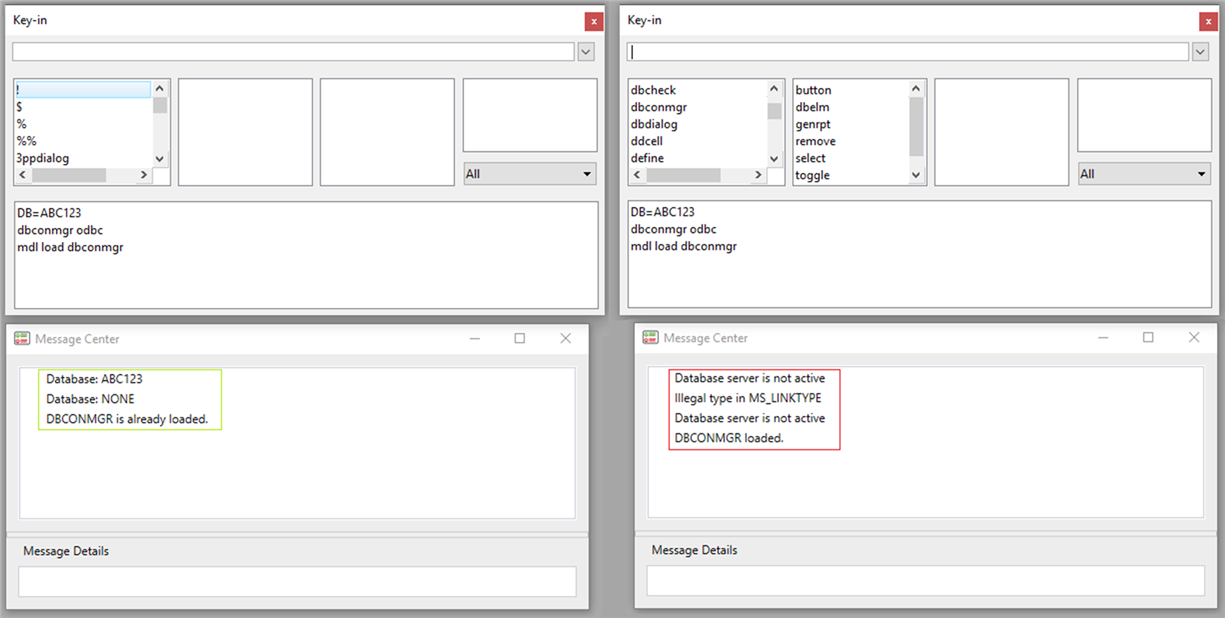

When MicroStation is launched from ProjectWise in the context of Managed Workspaces (Worksets) attempts to connect to a database via the MicroStation non-graphical database interface may fail.
Common expressions of the failure are, but not limited to:
Inability to Browse for Data Source from within the Connect to Database dialog:
An unresponsive DB= statement:
Under normal operation, when the connection type is set we should see the message:  Database: NONE
 After setting the connection type and executing a DB= command, we should likewise see Database: NONE  (if invalid), or the connection details, or the next step in the connection process (e.g. password dialog).
A failing session will likely display:
Illegal type in MS_LINKTYPE
and
Database server is not active
Key-in, Messages example
Failures expressed as above are an indicator that dbconmgr is unable to locate the requisite configuration variables.

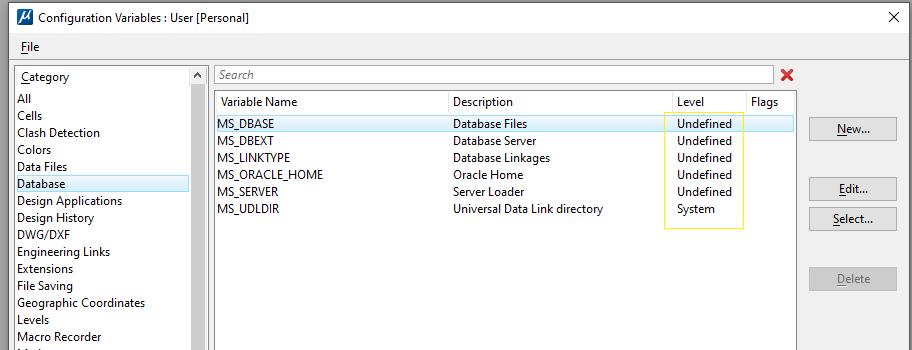

before database connection type is set, variables are undefined :
before setting database type

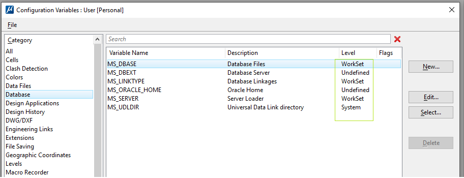

and e.g. after executing dbconmgr odbc :
after setting database connection type

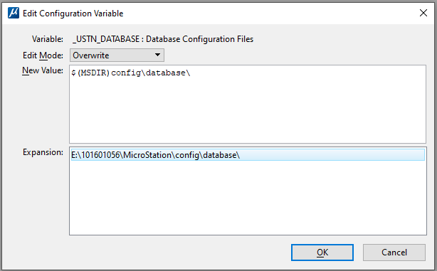

In a default desktop MicroStation installation, these configuration files are defined by the variable:
  _USTN_DATABASE
Directory containing MicroStation database configuration files.  (_USTN_DATABASE)
 as
$(MSDIR)config\database\
 * To check for the variable definition within a session of MicroStation, _USTN_DISPLAYALLCFGVARS must be set to 1
If set, all configuration variables (including those of the format _USTN_xxx) will be displayed.  (_USTN_DISPLAYALLCFGVARS)
Edit Configuration Variable: _USTN_DATABASE
If your Managed Workspace session of MicroStation is missing the _USTN_DATABASE definition and failing to connect, you will need to account for the variable within your Managed Workspace:
Configuration Block definition - ProjectWise Administrator
