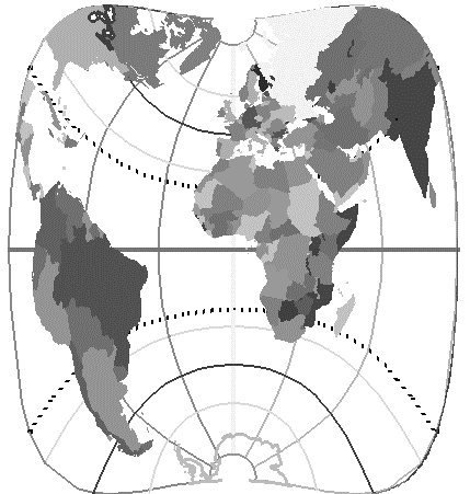

Cassini
Though not used commonly today, Cassini was once the standard for a number of European nations, including England and France. Developed in 1745 by C. F. Cassini de Thury for the first major survey of France. This projection is neither equal-area nor conformal. Most meridians and parallels are complex curves, except for the central meridian, the Equator and each meridian 90 degrees from the central meridian.

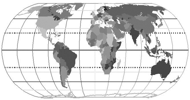

Eckert 4 (Eckert IV)
This projection and the similar Eckert 6 are only used for maps of the entire world. Part of a set of six projections presented by Max Eckert in 1906 of Germany, but only IV and VI have been used to any great extent. It is usually found on thematic maps showing world climate conditions or population distribution.
This projection is supported in the spherical form only.
In each of the six projections, the pole lines are half the length of the Equator. In Eckert 4, the parallels are not equally spaced apart but all are straight lines. The central meridian is straight, the outer meridians, at 180 degrees, are semi-circles. The rest are elliptical arcs, spaced equally apart. It is an equal-area projection.

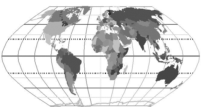

Eckert 6 (Eckert VI)
The Eckert 6 is an equal-area projection. The meridians are sinusoidal curves, except for the central meridian which is a straight line. Like Eckert 4, all parallels are unequally spaced straight lines. The Equator is twice as long as the lines at the poles.

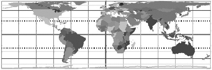

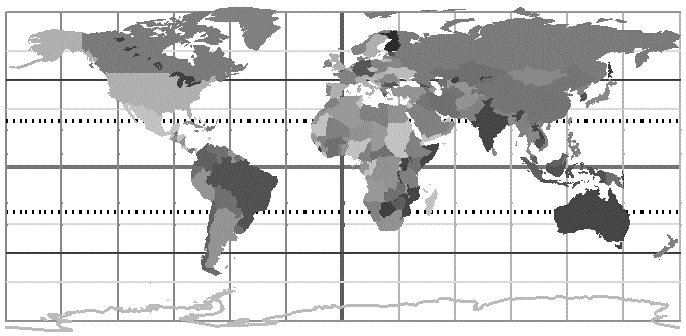

Equidistant Cylindrical
One of the oldest projections known, probably developed by Eratosthenes around 200 BC, its use is limited today. It is neither conformal nor equal-area, meridians and parallels are equally spaced straight lines.

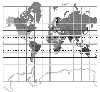

Mercator
The most well known map projection, it is conformal. Meridians are equally spaced straight lines. Parallels are straight lines, but not spaced equally. The Flemish cartographer Gerardus Mercator is generally accepted as the man who developed this projection around 1569. It is used mostly for navigation and has been the U.S. navigation standard since 1910.

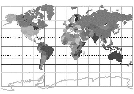

Miller Cylindrical
This projection is not conformal or equal-area. Parallels and meridians are straight lines, at right angles. Meridians are spaced equally, parallels get wider as you move away from the equator. First presented in the
U.S. in 1942 by O. M. Miller and is used mainly for world maps.

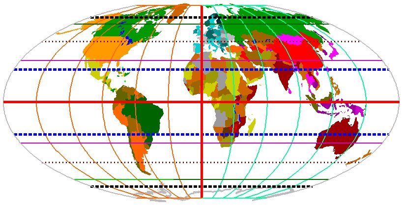

Mollweide
A cylindrical projection also used as the mid-latitude to polar regions of the Homolsine projection.

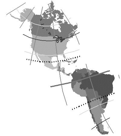

Oblique Mercator Projection
The Oblique Mercator is also known as the Hotine Oblique Mercator. This is a conformal projection. It is suitable for areas which stretch along a line that is oblique to meridians. Most commonly seen on grid maps of the Alaska panhandle (Zone 1) and single maps of countries encompassing areas as far apart as Switzerland, Madagascar and Borneo.
Most of the meridians and all of the parallels are complex curves. However, the two meridians which are 180 degrees apart are straight lines.

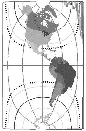

Transverse Equal Area Cylindrical
This is the transverse of the Normal Equal Area Cylindrical projection, proposed by Lambert in 1772. The central meridian is a straight line.
Meridians 90 degrees from the central meridian are also straight lines. The Equator is a straight line. All other parallels and meridians are complex curves.
The longitude of true scale is the central meridian or along two lines of longitude equally spaced from the central meridian.
Area is not distorted anywhere on this projection.
