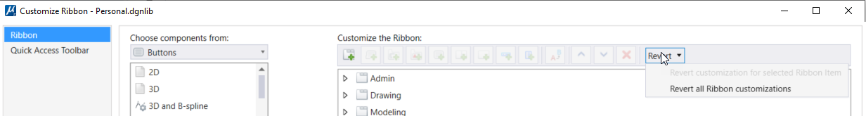

Note: Having moved (copied) the Ribbon Customizations to a new DGNLib, you may want to remove these from the original to save duplication. To do this open the DGNLib and use the key-in RIBBON CUSTOMIZATIONS REVERTALL. Alternatively use the tools within the Customize Ribbon dialog to remove individual items or Revert all.

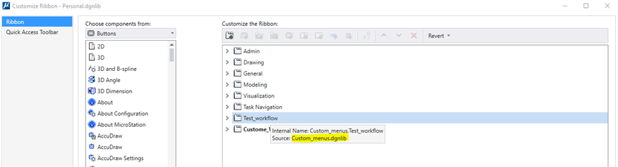

Locating Customizations
If you do not know which dgnlib a certain customization resides in you can hover over the item and a popup will appear showing the location and dgnlib where that component is stored.
