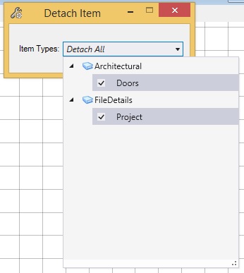

I have an element which has 2 Item Types attached
And I want to Detach “Doors” Item Type from the element.
Option 1 : Manual Option
When you issue a ItemType Detach key-in Or select the Detach Item icon from the ribbon, the Detach Item tool box loads where you can select the required Item type to delete. By default its set to Detach All Or the previous selection is retained.
Option 2 : Key-in
Key-ins can be used where you require some automation. I used BMR “Bentley Macro Recorder” (Drawing > Utilities > Macros) to get the following key-in.
Select the element and issue the following key-in.
MDL KEYIN Bentley.CustomProperties, Bentley.CustomProperties ITEMTYPE DETACH; ITEMTYPE SETTINGS DESELECTALL; ITEMTYPE SETTINGS SELECT Architectural\Doors; point absolute
