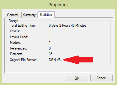

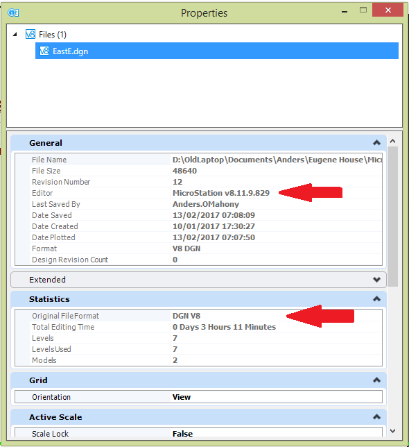

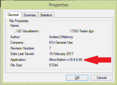

  1. The General tab will show the e.g. the Version of MicroStation to last Edit the file.
        2.   The Statistics tab will show the Original format of the file e.g. V8, V7 or DWG.
