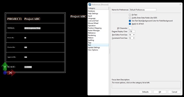

Apply Field Background from Text Style is not showing the BG color which is set in Text Style.
Turn on Hide Field Background Automatically is working fine but not feasible as it impacts others Text filed also.
Turn On the Use Text Style Background Color for Field Background option from the Preferences dialog.
Preferences dialog > Text > Use Text Style Background Color for Field Background – ON
How to change background color of Item type Text Field
