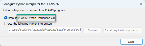

To confirm which exact folder to use, go to PLAXIS Input, menu option Expert > Python > Configure Python Interpreter and see what is used as Default.

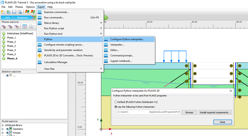

Since PLAXIS CONNECT Edition V20 Update 3 it is possible to configure PLAXIS to use a custom Python version, which is installed in the computer. To do so, the following steps are required:
  1. Start the PLAXIS Input as administrator from the Windows Start menu.
    It is important to have proper rights to install the required PLAXIS modules in the custom Python directory.
  2. Go to menu option Expert > Python > Configure Python Interpreter, select the option Use the following Python interpreter and browse to the custom Python distribution folder
  3. Select the option to Install required components.
    This will make sure all required modules and files for the PLAXIS scripting environment are installed in the custom Python directory.
  4. A popup window will provide information on the progress of the installation of the Python packages.
Figure 1. Configure and use a custom Python distribution
Note: changing to a different Python interpreter means that all options for Python, such as Run Python Script/Tool, Interpreter, Editor will use the custom Python interpreter as configured.
Any errors encountered during the installation of the required components may be linked to the custom Python version.
