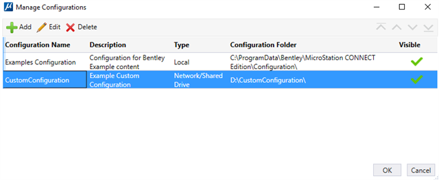

When I open MicroStation, my WorkSpaces and WorkSets are missing from the drop down menus located on the main Work Page.
It is likely your Custom Configuration location which included all WorkSpaces/WorkSets is not being read by MicroStation.
You can add/edit/remove Custom Configurations from the main Work Page as an end user via the Manage Configuration dialog.
More complex workflows may be needed from the CAD admin/management perspective.
For End Users
Beginning in MicroStation CONNECT Update 17, Custom Configurations can easily be added to a single machine via the Manage Configuration tool on the main Work Page.
Click on the "Manage Configuration" button as shown.
The Manage Configurations dialog will appear. Click on "Add"
Fill out the fields as necessary and press OK.
The new configuration should be added to the Manage Configurations dialog. Press OK (the new configuration does not need to be selected here).

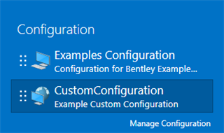

Now, select (left-click) the newly added configuration in the upper left portion of the main Work Page.
The WorkSpace drop-down menu should now show the WorkSpaces/WorkSets that are affiliated with the Custom Configuration.
