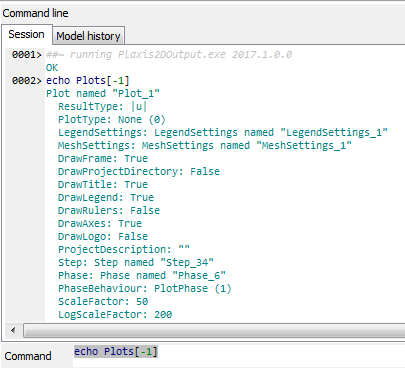

To view the current settings applied to the last plot created in Output, one can use the echo Plots[-1] command:
1_echo_plot
Figure 1. Current settings of Plots[-1] (last plot created)

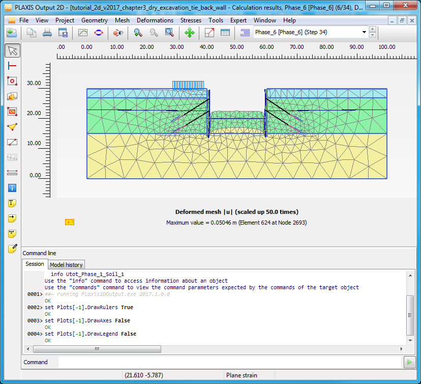

In the picture above you can identify different options that can be edited with the set command using the syntax below:
Show the rulers in your plot:
Hide the axes:
Exclude the legend of the plot:
2_plot_settings
Figure 2. Current view of the plot in PLAXIS Output

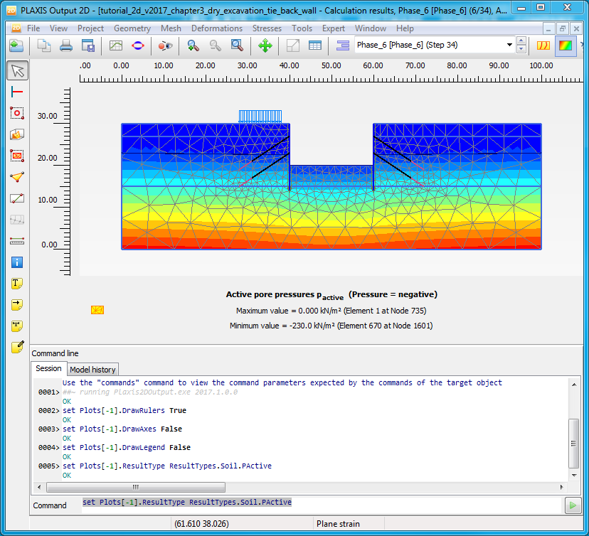

Set the plot results to Active pore pressures:
3_pactive
Figure 3. Plot set to show the Active pore pressures

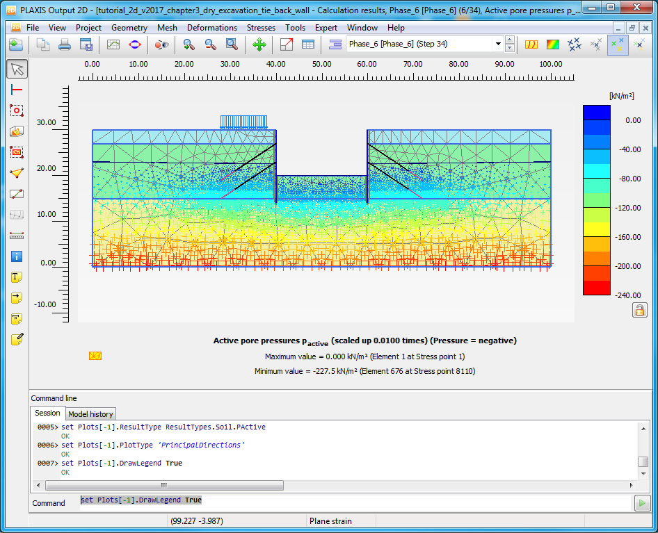

PlotType
For every plot you can also switch between the available visualisation options of the results:
Set the plot type to show the Contour lines instead of the Shadings:

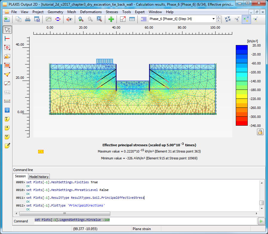

Set the plot type to show the Coloured principal directions of a plot. Note that this is relevant to some of the plots, such as the stresses and pore pressure plots:

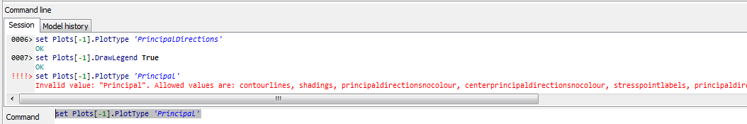

In any case that a typo is made, the error message contains all allowed values for the command.
4_principaldirection
Figure 4. Coloured principal direction with legend shown

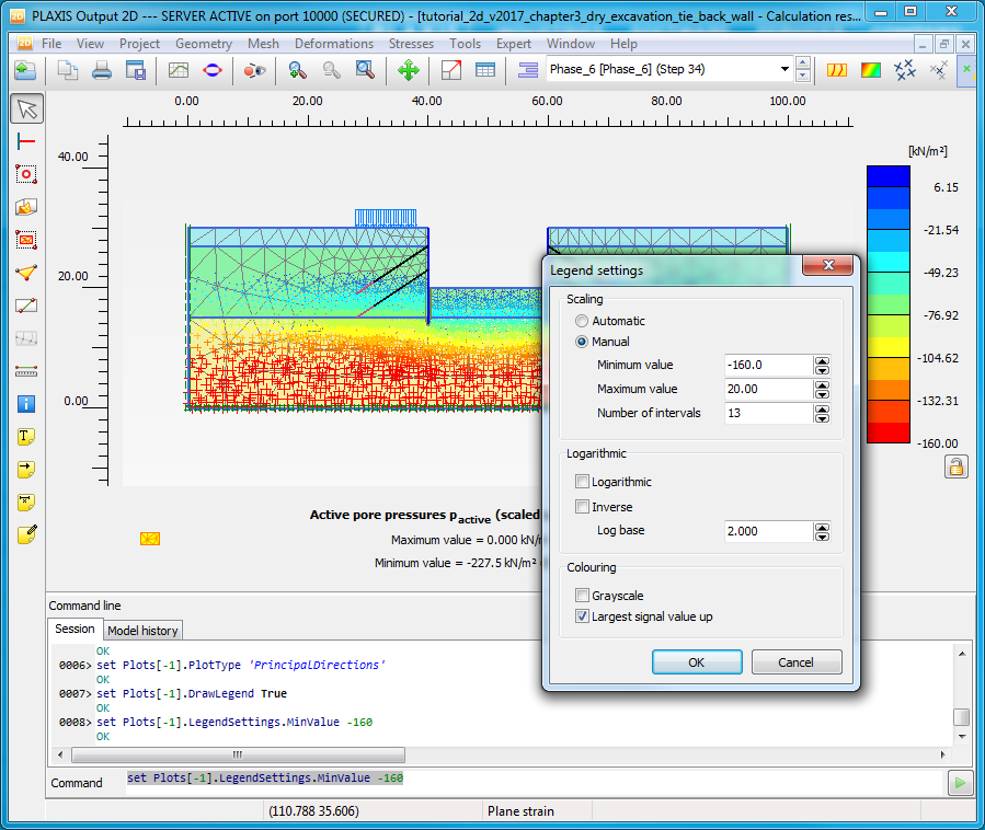

LegendSettings
This allows for changing the settings of the legend that is next to the plot. For example:
Change the number of intervals of the legend to 10:
Set the minimum value of the legend to -160 in project units:
6_minvalue_legend
Figure 6. Minimum value specified for legend

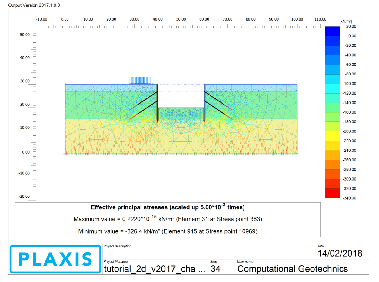

After setting up the plot the final step is to use the command line to export the plot to an image file.
The export command has the following structure:
An example is given below:
This command will export the lastly created plot (Plots[-1]) to the location specified within the quotation marks using the width of 1920 and height of 1080 pixels.
Note that the width and height are optional parameters which can be omitted. If those parameters are not mentioned the program will export the plot using 2880 x 2160 pixels.
Note that the export command for Plots[-1] will use the value of the Phase property according to what the PhaseBehaviour dictates.
8_exported_plot
Figure 8. Exported plot
