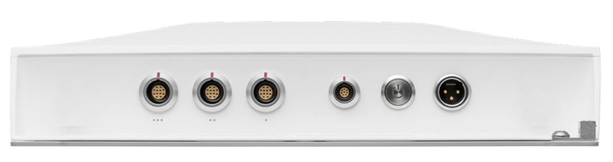

Each Thread Supports Three Devices
A Thread has three Device ports that can be configured to collect data from any supported Device. These Device ports are identified as ports 1 (right), 2 (middle), and 3 (left)

Thread Power
The Thread has a power button with LED diagnostics. The power input port is next to the power button, allowing the Thread to be powered on AC power or by solar panels.
