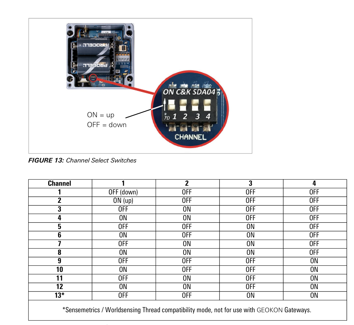

3.  Confirm the Dipswitch settings are configured to work with Threads. Important snipits from the Geokon manual are included below, indicating that channel 13 configuration is compatible with Threads. Channel 1- down, Channel 2- down, Channel 3- up, Channel 4- up. The full Geokon GeoNet 8800 manual can be found in the associated documents link here.

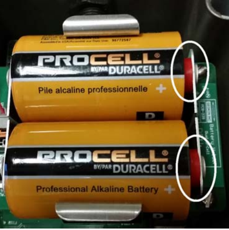

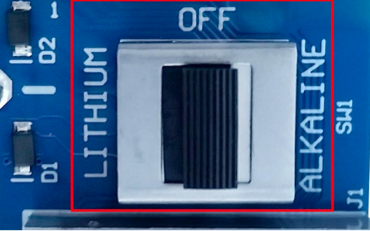

4. Before installing the D-cell batteries, ensure that the battery select switch is set to the “OFF” position (Figure 8). Configure the battery-type switch setting to the correct setting. (For units manufactured prior to June 2017, move the battery select switch to the OPPOSITE setting of the type of battery that will be installed.)
5.  Insert the batteries.

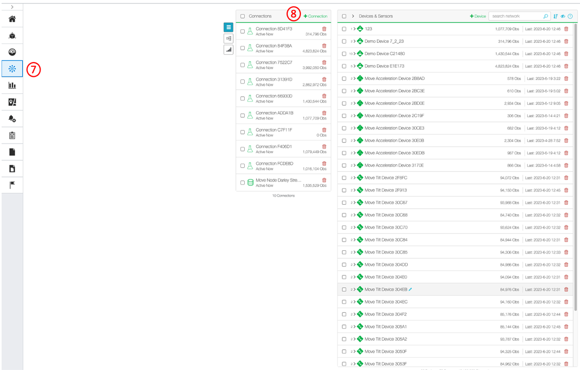

7. Select the   Icon on the left side of the page to access the connections page.
8. Select   at the top of the connections column.

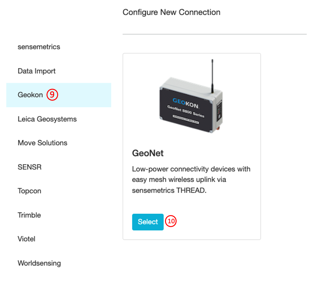

9. Select Geokon in the manufacturer column on the left-hand side of the page.
10. Click the   button under GeoNet.

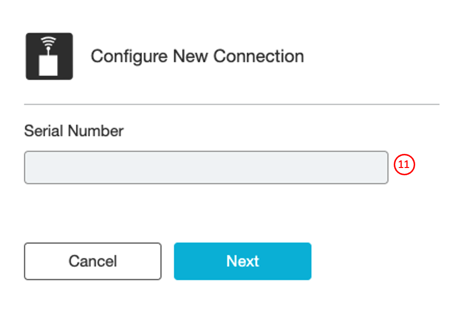

11. Input the serial number of the GeoNet that you would like to add to the iTwin platform. The serial number can be found on a sticker on the left side of the unit, labeled SN.
Note: If the GeoNet has not connected to a Gateway Thread, you will see the above "invalid Serial Number" error. Make sure to check the status of the GeoNet before trying to connect.

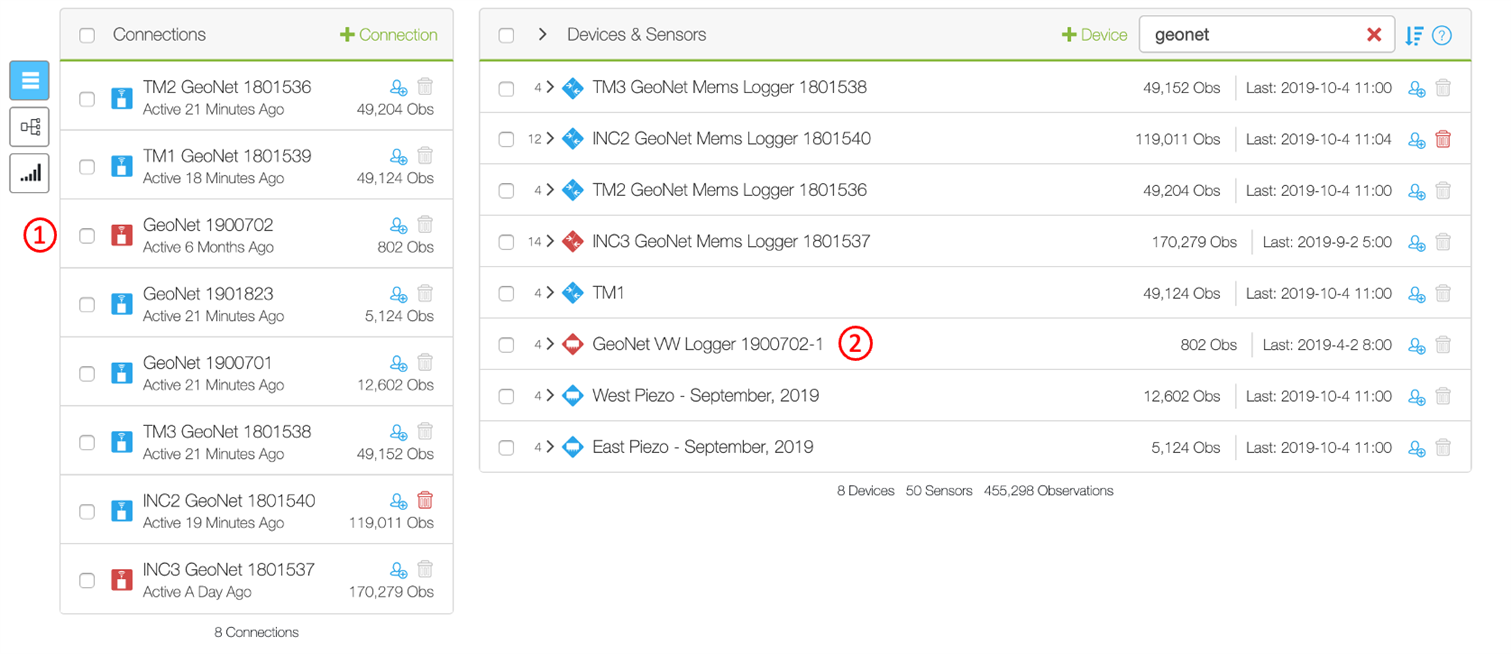

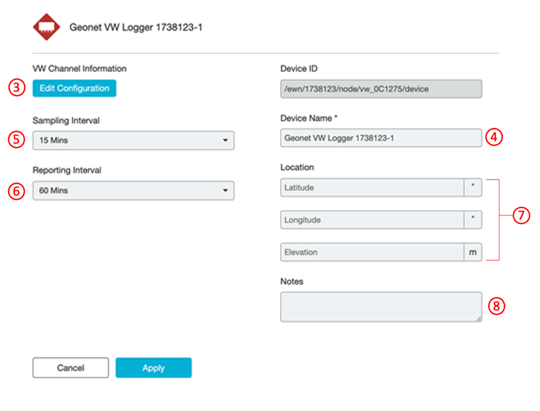

Your newly added GeoNet will now show up on the connections page as "GeoNet" plus its Serial Number. You may now begin configuring the GeoNet.
1. Highlight the box to the left of the GeoNet in the connections column.
2. Click on the GeoNet name in the Devices and Sensors column to access the Edit Configuration page.
3. Clicking the  button will take you to the configuration page for each wired VW you have in this GeoNet. Configuring these channels for vibrating wires will be covered in the article section below.
4. Here you can change the name of the GeoNet. it is recommended to keep the Serial Number in the name next to the changed name for easier troubleshooting.
5. The sampling interval can be changed from 5 minutes to 24 hours, depending on the desired sampling frequency of the wired sensors.
6. The reporting interval tells the strand when to send data via radio to its connected Gateway Thread. It is recommended that this interval matches the wake duration of the connected Gateway Thread to allow for easier data transmission.
Note: It is recommended to keep the reporting interval shorter or the same as the sampling interval to make sure that the GeoNet does not build up a large backlog of data.
7. Setting the location of the GeoNet will allow you to view the connection in the correct location in the Spatial Module. This can also be done by dragging and dropping the GeoNet icon in the Spatial Module.
8. Notes can be added in this section for any important information about the setup or use of the connection.
NoteBe sure to hit apply after any changes have been made to the configuration or they will not save.

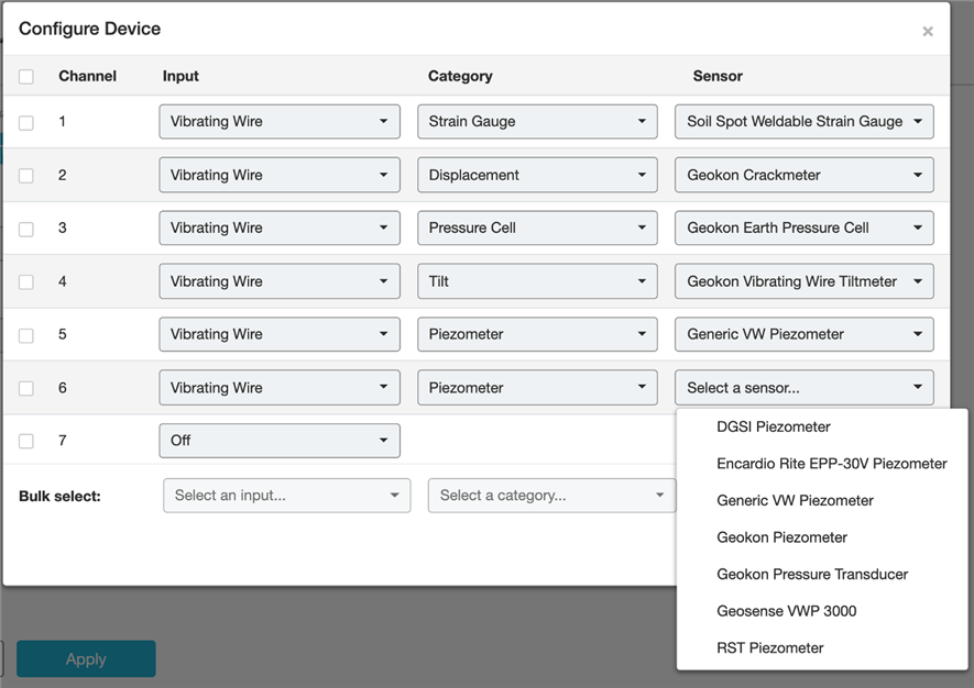

The Vibrating Wire Sensor on the GeoNet will need to be configured to the specific VW sensor you are using. First, navigate to the device in the 'Devices & Sensors' list on the right-hand side of Network and click the device you wish to configure.
You will be taken to the 'Details' tab for the selected device. Click the 'Edit Configuration' tab in the side navigation menu. Finally, click the blue "Edit Configuration" button under VW Channel Information.
Within the configuration modal, you should specify the input type, sensor category, and sensor type for each channel. Dependent on your inputs, different parameters will be available for selection.
Click Apply when finished and make sure to click Submit within the configuration page to write the settings. Once saved, the configured vibrating wire sensor will populate beneath the GeoNet Device and can be viewed by clicking the drop-down arrow.
Additional calibration factors and other parameters will need to be entered for most types of vibrating wire sensors to See the Vibrating Wire article for details.
