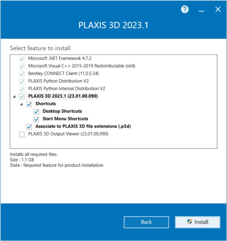

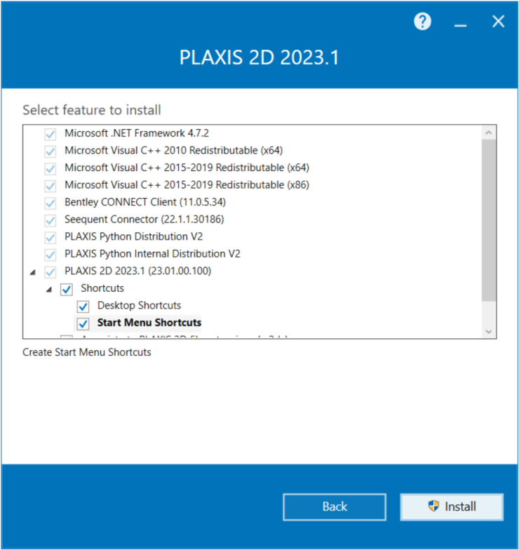

  5. (Optional) Select the features which you want to install.
    1. On PLAXIS 2D:
    2. On PLAXIS 3D:
  6. Click Install to start the installation.

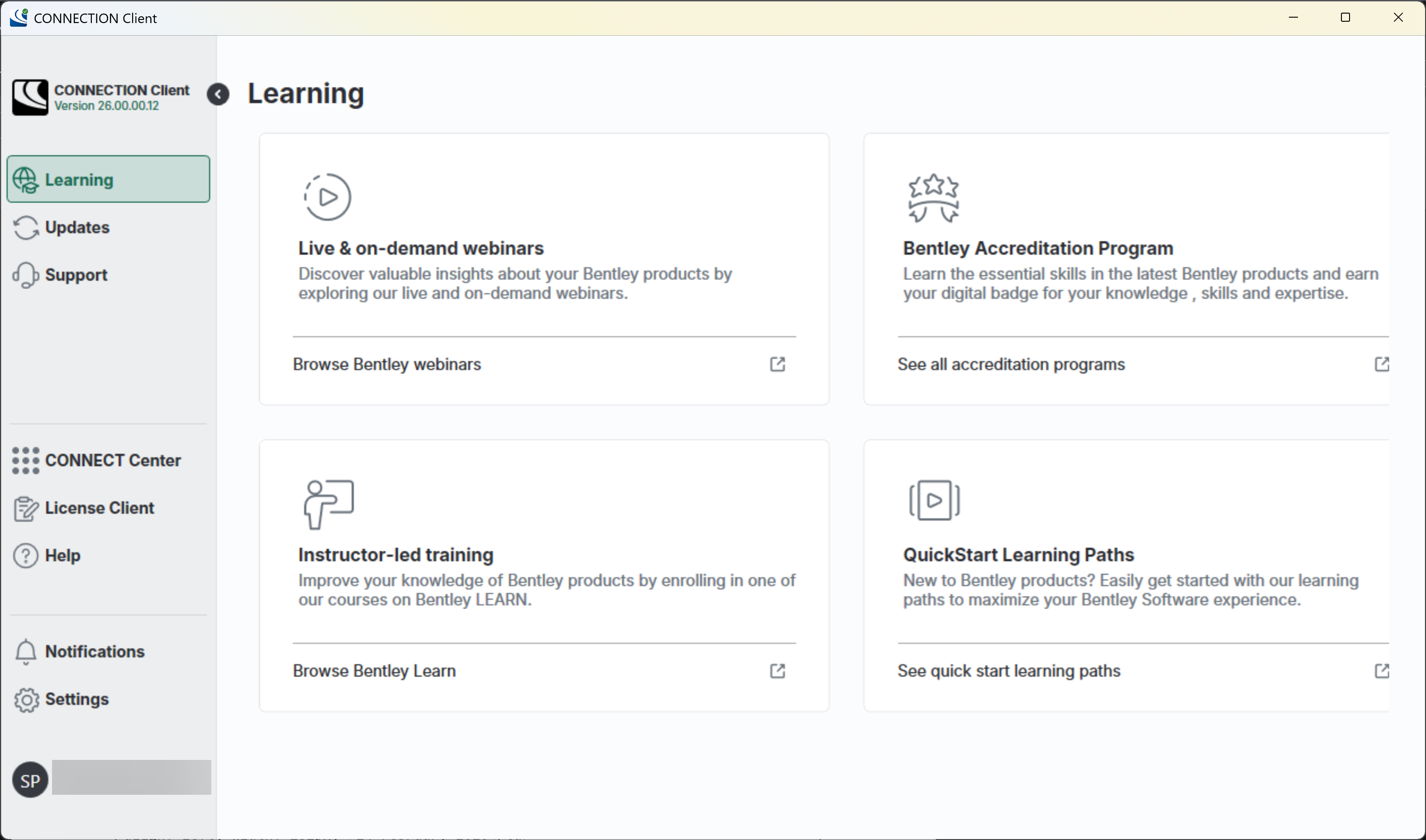

Update install - Using CONNECTION Client
When PLAXIS is installed for the first time, the CONNECTION Client is installed as well:
When there are updates available for PLAXIS (or any other Bentley products), the CONNECTION Client will notify you. You can install the update by clicking the Update button in the CONNECTION Client.
You can also use the CONNECTION Client for Learning, Support, License Client and your CONNECT Center.
The CONNECTION Client can update itself, too. It is recommended to keep it up-to-date.
Sign into the CONNECTION Client and refer to its Help for information on managing notifications and installing application updates. For more information go to the link CONNECTION Client on the Bentley communities website.
