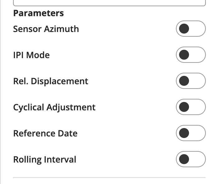

Temporary Metric Related Parameters
Within certain modules, you will be able to apply temporary metric related parameters as seen in the image below. These will override the settings set in the previous image and will only apply to this particular instance within iTwin IoT. This can be in Tables, Graphs, Correlation Analysis and others. Whenever a metric is availble for selection it's parameters will be exposed as a temporary override for the Device set parameters.
Reference Date
A reference date will become available when a sensor uses delta calculations. This is most common with any type of Position or Tilt measurement. The reference date will specify the first date used when calculating the amount of change within a certain time frame.

Rolling Interval
A rolling interval will become available when a sensor uses delta calculations. It will set a moving time window that applies a reference calculation on every point. A rolling interval of 1 week will take every point to be analyzed and will compare it with a data point exactly one week prior and calculate the difference.

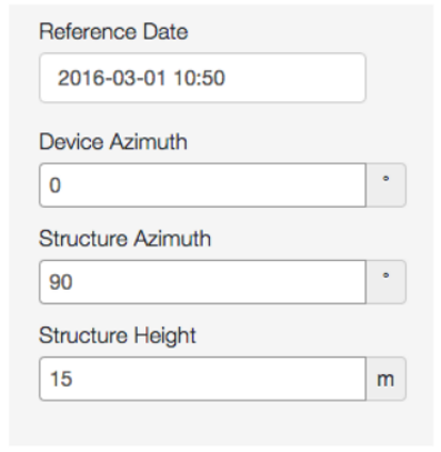

Sensor Azimuth
Sensor Azimuth will become an available parameter when using a sensor that measures position or tilt but does not automatically realize the North/East directions.
In order for the Northing and Easting calculations to represent actual Northing and Easting, you will need to specify the sensor azimuth.
For more information on what a Sensor azimuth is please read through this article.
Structure Azimuth
Structure azimuth will become an available parameter when using a sensor that measures Position. This field will allow you to orient the Transverse/Longitudinal Axis in any desired direction. It is useful for finding movement in the direction of a specific structure or any point of reference.
For more information on what a Structure azimuth is please read through this article.
Structure Height (Gauge Length)
Structure Height is a field that is available for tilt sensors.
Enter the Height of the structure from the base to the top of the structure. This will use a trig calculation with the Tilt X/Y angle to create an X/Y Vector at the top of the structure.
Specify the Structure Height to use X/Y calculations and allow vectors in Map View.

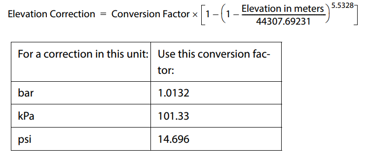

Elevation correction
This is for correcting the barometric pressure(p. 14) for elevation.
Atmospheric pressure decreases about 0.5psi for every 1000 feet of elevation.
The value inputted should be the elevation value in feet or meters.
