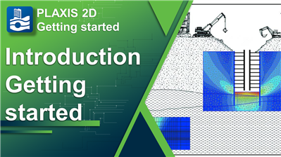

Getting Started with PLAXIS 2D
This training unit introduces the PLAXIS 2D program and its workflow.
Using the example of a deep excavation analysis, we will cover how to set up soil layers, structural elements, generate the mesh, define flow conditions and set up the staged construction. After the calculation, we will have a look at the results.
Watch the training on YouTube here

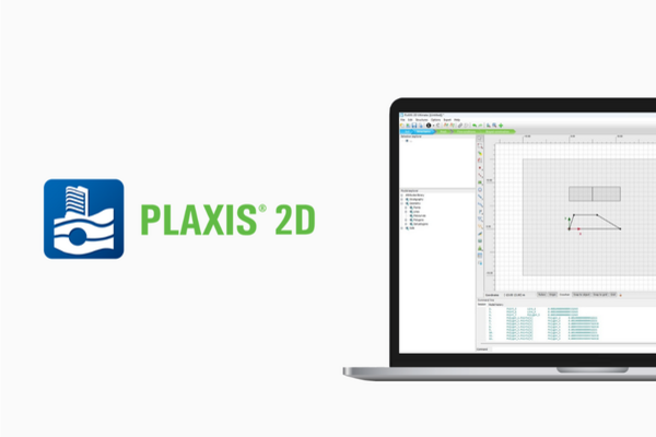

Importing CAD Geometry in PLAXIS 2D
CAD drawings and finite element models are built for different purposes. This course bridges that gap by teaching you how PLAXIS interprets imported geometry and how to prepare CAD data for successful analysis. Learn best practices for DXF import, geometry validation, mesh quality assessment, and geometric repair so you can build robust PLAXIS 2D models from CAD data with confidence.
Watch the training here *
