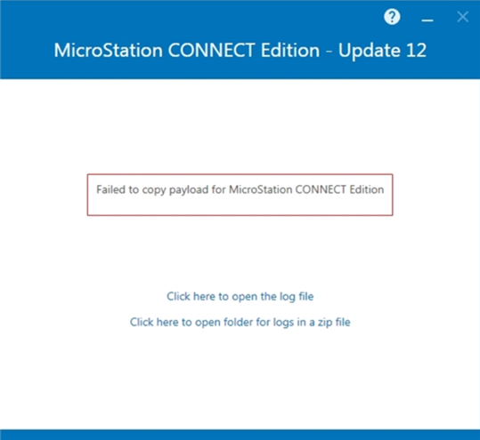

During the installation of MicroStation, the message "Failed to copy payload” error appears and the installation cannot be completed.

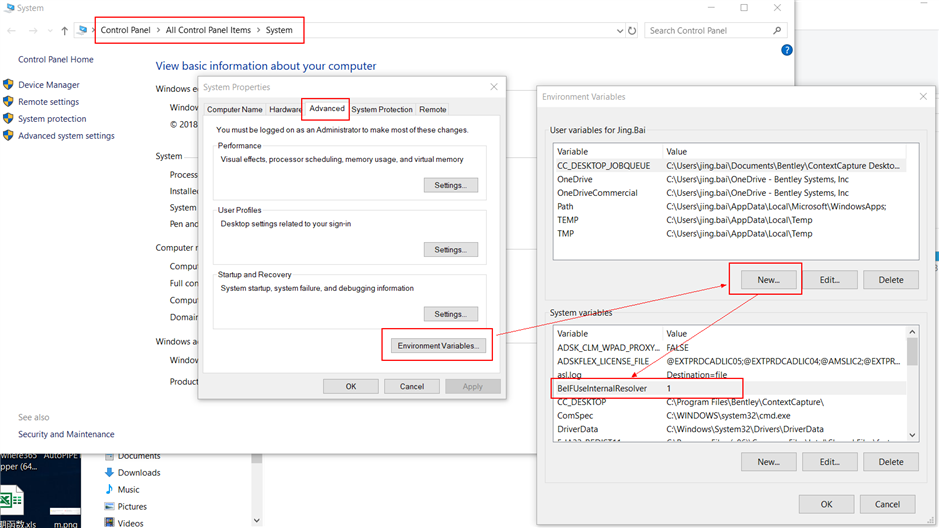

Option 3
Create a new Windows system environment variable BeIFUseInternalResolver and set its value to 1.
BeIFUseInternalResolver = 1
Open the System> Advanced system settings> System Properties dialog from the Control Panel.
Create a new variable from the Advanced tab> Environment Variables> New button.
After creating the system environment variable, reattempt the MicroStation installation.
