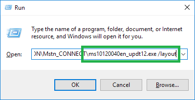

- In the command line, go to the folder that contains the MicroStation setup executable and run the executable with the /layout command.

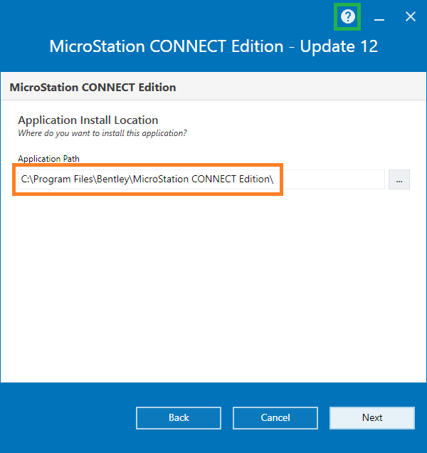

- (Optional) To change the application installation location, click the Browse button next to the Application Path.
We recommend that you accept the default install location unless there is a particular reason not to:
In the Browse For Folder dialog that opens, browse to the drive and folder you want to install the product in, then click OK.

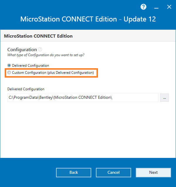

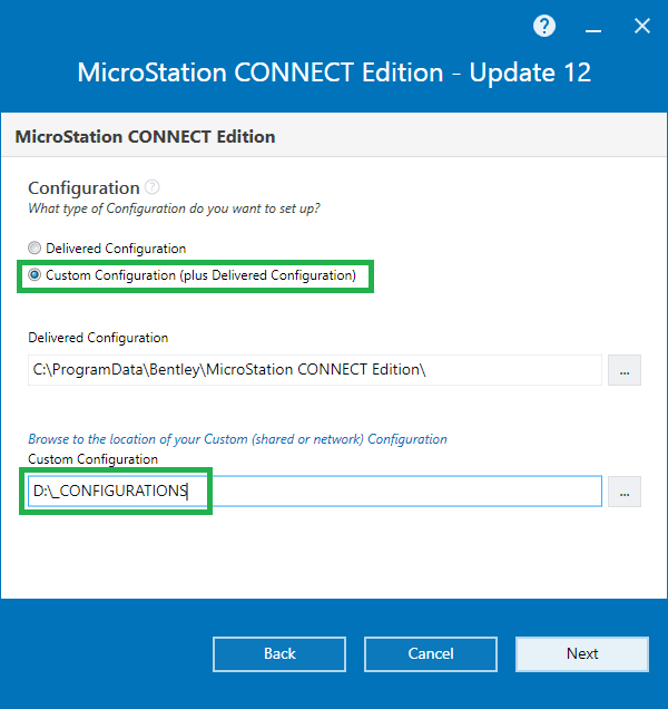

In the following (optional) step we have an option which sets the location of the Custom Configuration during installation. This eliminates the need to run additional procedures to deploy customised configuration files to each installation. We recommend that deployment Images are created using this step.
Select the 'Custom Configuration (plus Delivered Configuration)' option. Browse to the folder where your Custom Configuration will be located, then click next:
The Custom Configuration location does not need to have been populated with content or even to exist for the deployment image to be created successfully. MicroStation will still run without them but only with the delivered configuration and the MetroStation example dataset. Obviously the Custom Configuration location and content will be required for production installation to be completed.
Note that this is a change from pre-update 4 versions where other options were offered at this point. Organization and Workspace settings are now applied in the copy of WorkSpaceSetup.cfg that will be located in the Custom Configuration.
Click Next to continue.

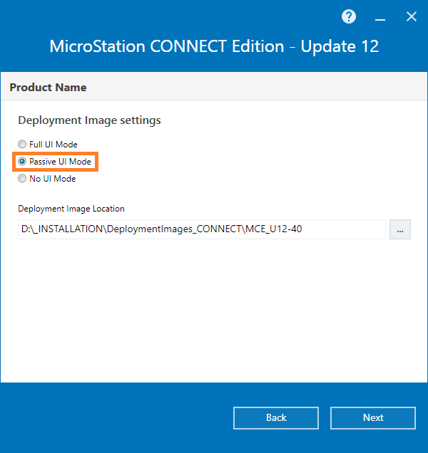

- Select the installation mode, 'Passive UI Mode' is the default that applies to most situations as mentioned above.
Browse to and select the Deployment Image Location, creating a separate sub-folder for each deployment image:

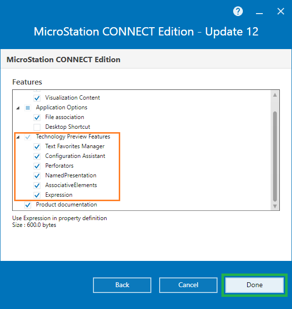

- In the Features stage the optional features that are installed can be modified. The most likely option to consider here will be to omit the Technology Preview Features in production environments where they may not be needed immediately.
Click Done to accept the choices made or back to review.

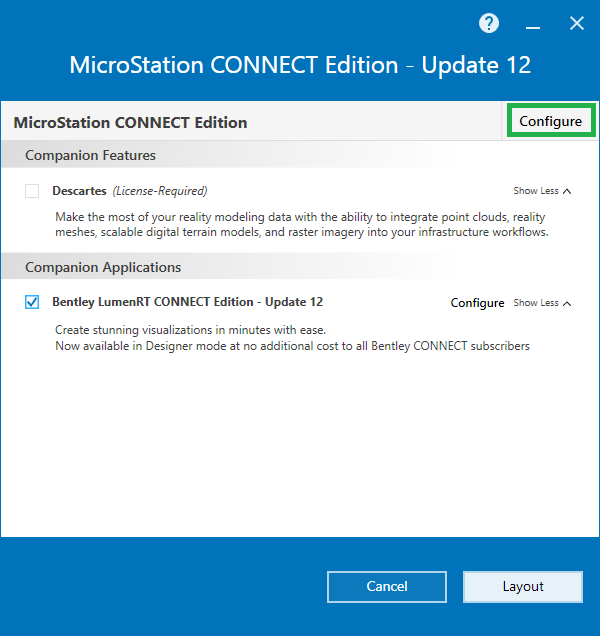

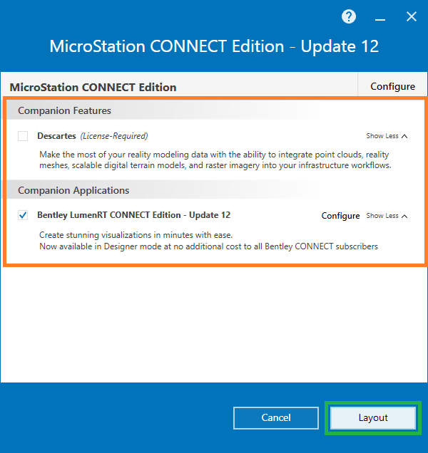

- Check state of Companion Feature and Applications selections then click layout to create the deployment image. The usual installer dialogs will appear, required (or potentially required) components will be downloaded including the Companion Features and applications

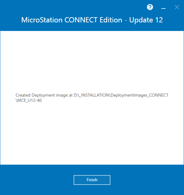

- Click Finish to exit the MicroStation Installation Wizard.
The deployment image is created at the selected location.

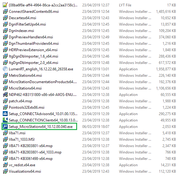

- The resulting files created will be similar to this:
Observe that in addition to the 1.6Gb MicroStation installation file, there is also the 1.8GB LumenRT installation file and a 1.5Gb CONNECT Shared Content file that contains installation files for companion features and other shared content.
These files are included in the deployment image so that all required files are available on the local network during installation without the need for further online downloads speeding up the installation and avoiding repeated downloads of the same files.
- Run Setup_MicroStationx64_10.0n.00.0nn.exe to install. This can be done:
