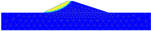

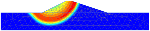

In this tutorial, the construction of an embankment on clay is calculated. The clay will first be considered a drained material and then an undrained material. For both cases the factor of safety will be determined. This would for instance give an indication of both the long term and short term stability of the embankment.
 Failure mechanism for drained case (top) and undrained case (bottom)
