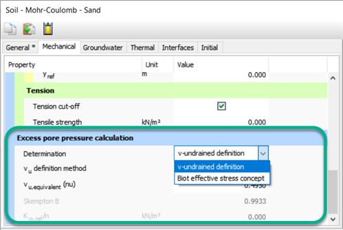

PLAXIS 3D CONNECT Edition V22
Material definition
The material definition for soil/rock and structures has been enhanced. The changes concern:
For material properties changes, i.e., on objects and commands, check the Commands reference under the Help menu in both Input and Output.
Undrained behaviour is renamed to Excess pore pressure calculation
The soil material category has been updated to better describe the group of properties that can simulate an incompressible soil by selecting the determination of the excess pore pressures to be based on a v-undrained definition, Skempton B based or following the Biot effective stress concept (αBiot).
