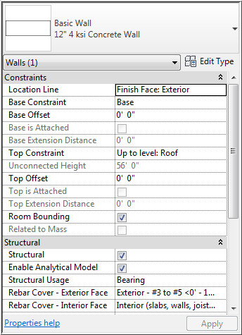

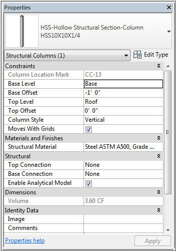

Be sure to set the Base Level (The base level is any level at the bottom of the column. It does not have to be named Base as shown here.) and Top Level appropriately for columns and the Base Constraint and Top Constraint for walls as shown below:
Set Wall Base and Top Level to correct reference levels

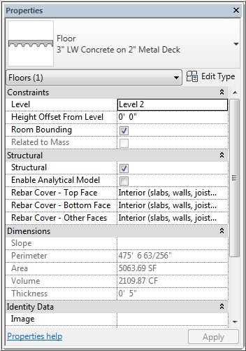

Set the level for floors to the closest story level. Don’t offset the floor from a different story level because that will be the level the floor is imported into RAM Structural System.

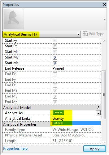

Analyze As
Revit Structure provides this property for beams, columns, and braces.  Braces will always be exported to RAM Structural System as lateral members.  To export beams and columns as Lateral members, be sure to set the Analyze As flag accordingly:
Beam with “Analyze As” flag set to Lateral
