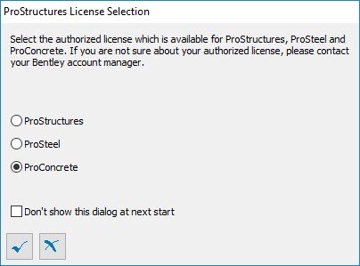

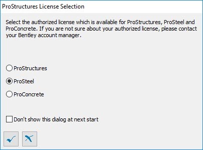

By default when ProStructures application is launched, the License Selection box appears. However user can select their owned license and can check the box so that this dialog box should not appear next time.
The Select License tool can be accessed via ProStructures Tasks menu or can be accessed via main menu, ProStructures > Setup > License

(B) ProSteel :
Selecting ProSteel License, one will only use ProSteel and get access to use all ProSteel tools and features, but will not be allowed to use ProConcrete tools and features. This is useful for those users who only works with Steel Structures.
(C) ProConcrete :
Selecting ProConcrete License, one can only use ProConcrete and get access to use all ProConcrete tools and features, but will not be allowed to use ProSteel tools and features. This is beneficial for those who just need to work with Concrete and reinforcement work.
It is strongly recommended to select the correct license which you owned, otherwise you will get Over usages charges.
