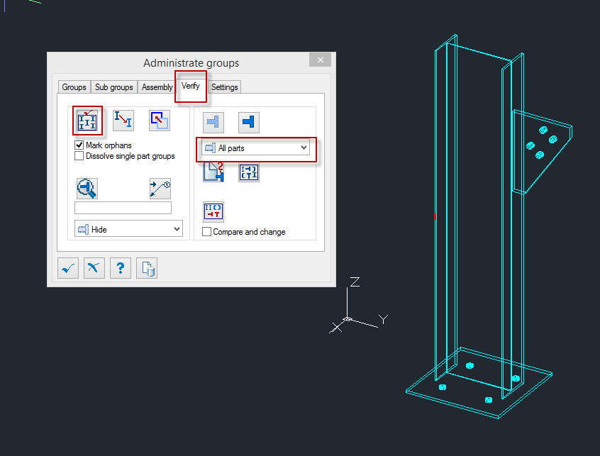

Scenario:
    A column which got a Baseplate and a Gusset plate. The column, baseplate and gusset plate are not group together. Verifying the model, you can see below that the  elements are not part of any group.
To Create a group within Prostructures

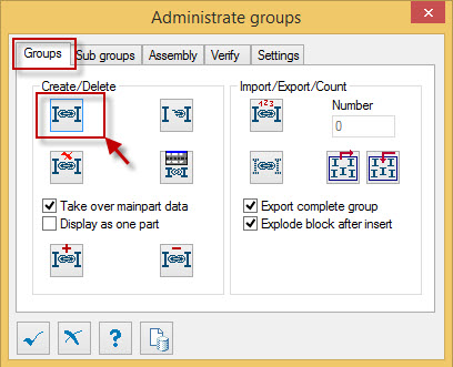

   1. To create a group. Open the Administrate group command, then go to the Group TAB.
2. Select the Create Group ICON
    Prompt: Select Main part of the group: (Select the column)
    Prompt: Select Objects: (Select the baseplate and the gusset plate)

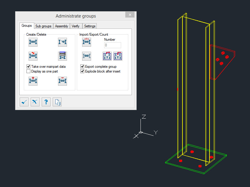

3. After the selection the column, baseplate and gusset plate are now grouped together.
