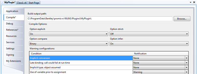

  3. The project properties will appear in the main window. Here we will set several project properties that control how the project is built and run. Click the Compile tab. For the "Build output path" field, click Browse and select the "plugins" subfolder of the [[5366|Program data folder]].  The MyPlugin folder will not exist initially. You may create this folder manually, or Visual Basic will create it when the project is first built.

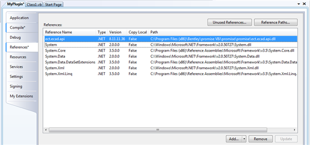

  4. Click the References tab. Here we will add references to the promis-e assemblies. Click the Add… button. Select the Browse tab. In the "Look in" field, browse to the [[5365|Program folder]]. Select the file: ECT.ECAD.API.dll – (General API)

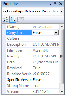

    When the file is added to the references list, its Copy Local property will be set to True. Set Copy Local to False by selecting the reference and changing the value in the Properties window.
