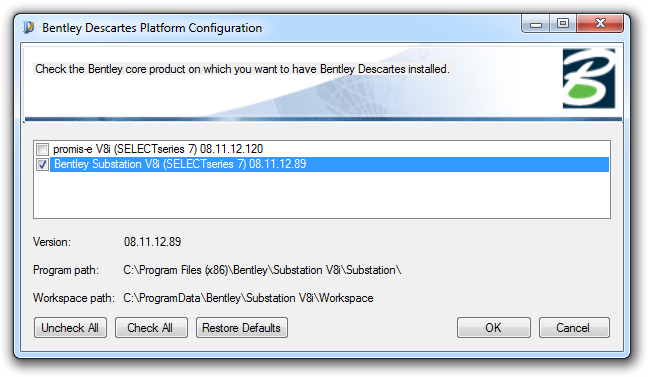

  1. Download Bentley Descartes for MicroStation from the Fulfillment Center.  Bentley Descartes for MicroStation is a different application than Bentley Descartes, which is a standalone application and a much larger download.
  2. With Bentley Substation already installed, install Bentley Descartes for MicroStation.
  3. Near the end of the installation process, choose to open the Bentley Descartes Platform Configuration dialog and finish the installation. Alternatively, after installation select Start > All Programs > Bentley > Bentley Descartes for MicroStation V8i > Bentley Descartes Platform Configuration.
  4. Set the check box next to the desired application in which the Descartes tools should be available.
  5. Click OK.

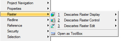

Tools
When Descartes is loaded, Tools > Raster will list "Descartes" sub-items
and Raster Manager will have a Tools menu and will list About Descartes V8i in a Help menu.
