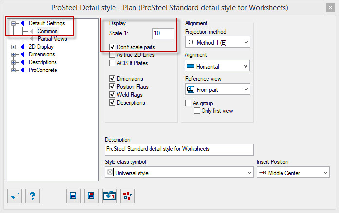

 Changing the Scale, Text Size and Text Distance
  1. By editing the Detail Style > Default Settings >  Common
These settings will affect the scale of the text but not the parts.

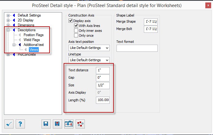

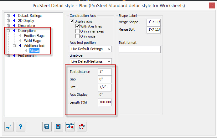

2. By editing the Detail Style > Descriptions > Additonal Text > Views
These settings will give you options to change the text distance and its size. Depending on the scale you, set this will affect the appearance of your Gridlines
