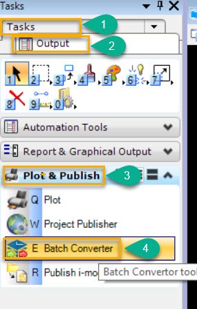

          In Task bar, Click Task ->Output->Plot &Publish ->Batch Converter

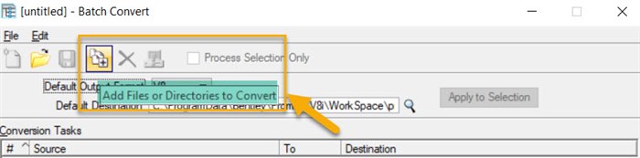

  2. Click the button that has a tool tip of Add Files or Directories to Convert and add the DGN files for the desired project pages.

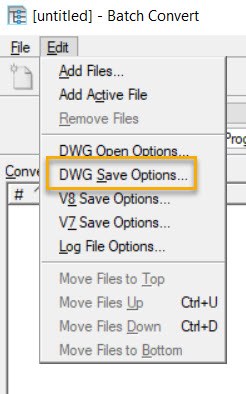

  4. Check the settings in Edit > DWG Save Options.

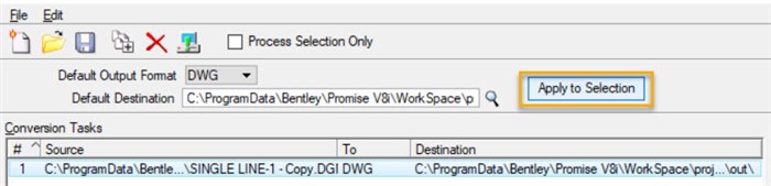

  5. Select the files in the bottom pane and click Apply to Selection button.

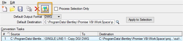

  6. Click the button that has a tool tip of Process Batch Convert Job or select File > Process.

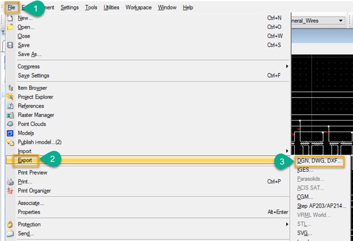

  2. CONNECT Edition: Select File ribbon tab > Export > Common File Types > DWG (*.dwg)
    V8i: From the main pull down menus select File > Export > DGN, DWG, DXF...

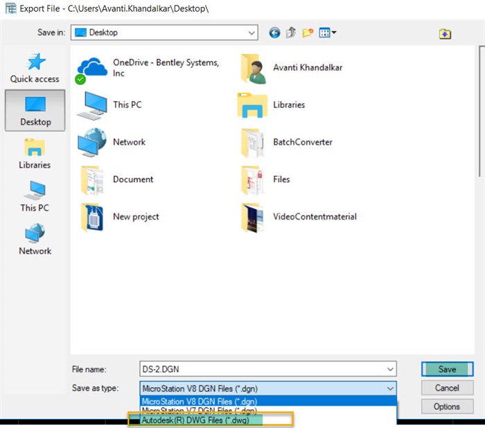

  3. Specify a file name, destination folder, and set Save as type to "Autodesk(R) DWG files(*.dwg)"
  4. Click Options to review Save As DWG/DXF Options, click OK.
  5. Click Save.
