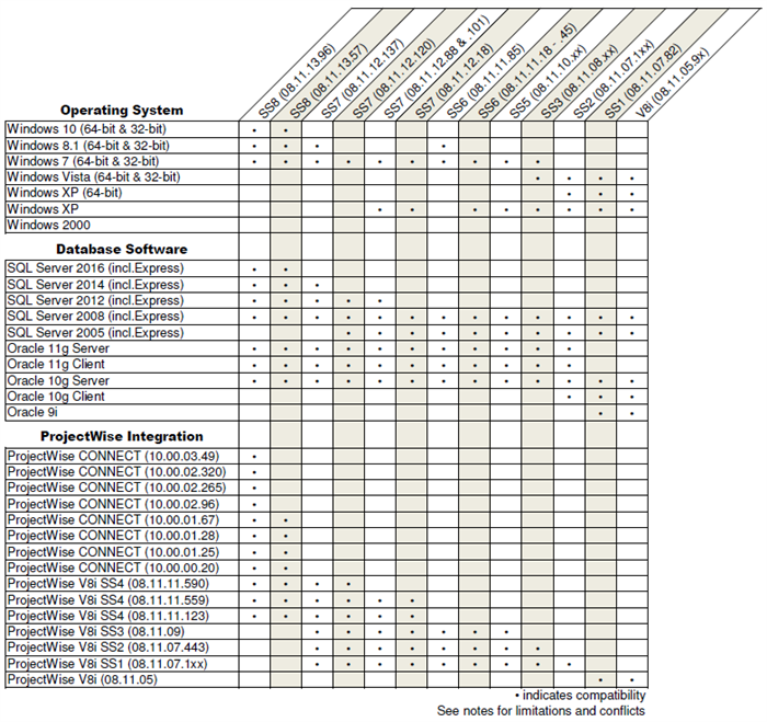

The purpose of this document is to indicate the compatibility of various software with Promis.e. It is not intended to describe compatibility of the various software with each other. For example, certain versions of SQL Server may not be compatible with certain operating systems. Always check the documentation of the various software involved.

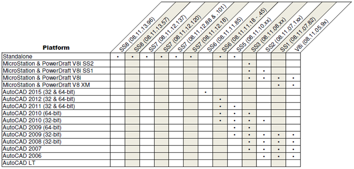

MicroStation/PowerDraft V8i is version 08.11.05.17
MicroStation V8i SS1 is version 08.11.07.171
MicroStation PowerDraft V8i SS1 is version 08.11.07.172
MicroStation PowerDraft V8i SS2 is version 08.11.07.443
There is no promis.e V8i SELECTseries 4. The SELECTseries release after SELECTseries 3 was named SELECTseries 5 in order to match the concurrent release of Bentley Substation V8i SELECTseries 5.
Beginning with promis.e V8i SELECTseries 5, the "Standalone" version of Promis.e has the MicroStation CAD engine built into the Promis.e install. Going forward there will not be new "add-on" versions for MicroStation or PowerDraft.

- AccessDatabaseEnginex64 is included with 64-bit Microsoft Office 2010 but can also be downloaded and installed separately. Download AccessDatabaseEngine_x64.exe.
- Office 2007 is a 32-bit application only, and the AccessDatabaseEngine_x64 cannot be installed on top of it. To use Office 2007 and 64-bit Promis.e, install AccessDatabaseEngine_x64 prior to (re)installing Office 2007.
- If Office 2010 is to be used on the same workstation as 64-bit Promis.e, install the 64-bit version of Office 2010.
- In one case with 64-bit Promis.e, it was still required to install AccessDatabaseEngine_x64 separately after installing 64-bit Office 365.
- 32-bit Standalone Promis.e will operate on a system with 64-bit Microsoft Office installed with no additional action necessary.
- For Promis.e V8i SS8, database versions are certified in the same language as the product you installed. For example, if you are using a Russian version of SQL Server, use a Russian build of Promis.e.
- Promis.e prior to SS8 is only certified on English SQL Server versions, even for versions of Promis.e localized for other languages. The SQL_Latin1_General_CP1_CI_AS collation is recommended.
- Install the 32-bit version of the client if using 32-bit Promis.e even if the operating system is 64-bit (i.e. using Promis.e Standalone). Install the 64-bit client if using 64-bit Promis.e (i.e. Promis.e for 64-bit AutoCAD).
- For Oracle 11g with Promis.e V8i SS6, SS7, and SS8, ODAC 11.2 Release 3 (11.2.0.2.1) is required. Installing the Oracle Universal Installer ODAC112021.zip is a convenient way to install the requirements for Oracle with Promis.e V8i onto the client. ODAC112021.zip includes the 11.2.0.2.0 Instant Client.
- For Oracle 11g with promis.e V8i SS2 through SS5, install the 11.1.0.7.0 Instant Client. Installing the Oracle Universal Installer ODAC1110720.zip is a convenient way to install this client and other the other requirements for Oracle with promis.e V8i.
- Later releases of the Oracle 11g client such as 11.2.0.1.0 are not compatible with promis.e V8i SS2 through SS5. Even though it is not certified for Windows 7, ODAC 11.1.0.7.20 will work in that operating system.
- For promis.e V8i SELECTseries 5 - 7 and Oracle 10g server, v10.2.0.4 or higher is compatible.
- For integration with ProjectWise 08.11.07, ProjectWise Explorer 8.11.7.133 or higher is compatible.
- Integration with ProjectWise is not required.
