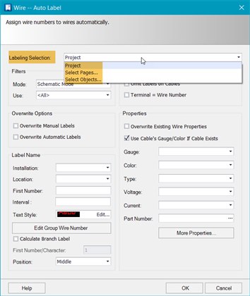

2. Next Specify the Labeling Selection according to your requirement, i.e. for assigning Wire Number to all wires in the Project select Project, for assigning Wire Numbers to all the wires on a particular Project Page use Select Pages and for assigning Wire Number for selected Wires in a page use Select Objects.

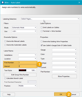

3.  Next specify the First Number and Interval under Label Name according to your requirement.
e.g. If there is requirement for assigning odd numbers to a group of wires you can use a starting number of 1 and specify an interval value of 2. Select OK to assign the wire numbers.

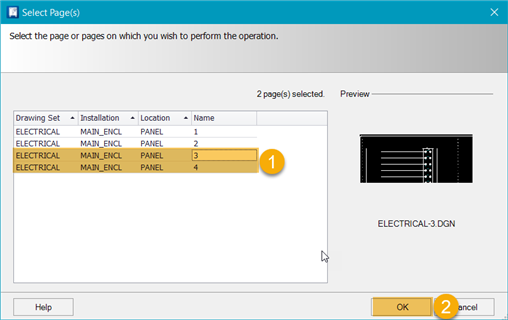

Select Pages
- Next in Select Pages dialog select page(s) and then select OK and Wire Numbers will be assigned.
Note: Use Ctrl + Select page for multiple page selection.

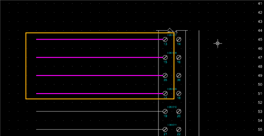

Select Objects
- Next select the logical wires that require wire numbers to be assigned automatically and then right click to assign wire numbers.
