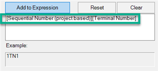

In below you can see that Wire number (assigned using by Automatic wire number) and the Terminal number are same so we can match these both number eg. if the terminal is 6 then the wire will be 6.
For convenience purpose we can assign wire number as the terminal number by using Automatic wire number.
There are 2 options to renumber the terminal to match the wire number that gets assigned by following below procedure,
There is a checkbox in the automatic wire numbering dialog, under Label Options, which says "Terminal = Wire Number"
Below are the steps,
To make the Wire Number take on the value of the Terminal Number that you have already assigned, then follow below steps
NOTE:- Unrelated wires that connect to terminals that have the same number, the wires will take on the terminal number and a suffix based on the format chosen,
much like wires that exist on the same line number would get 7 is the Terminal Number and 7.1 is Wire number
