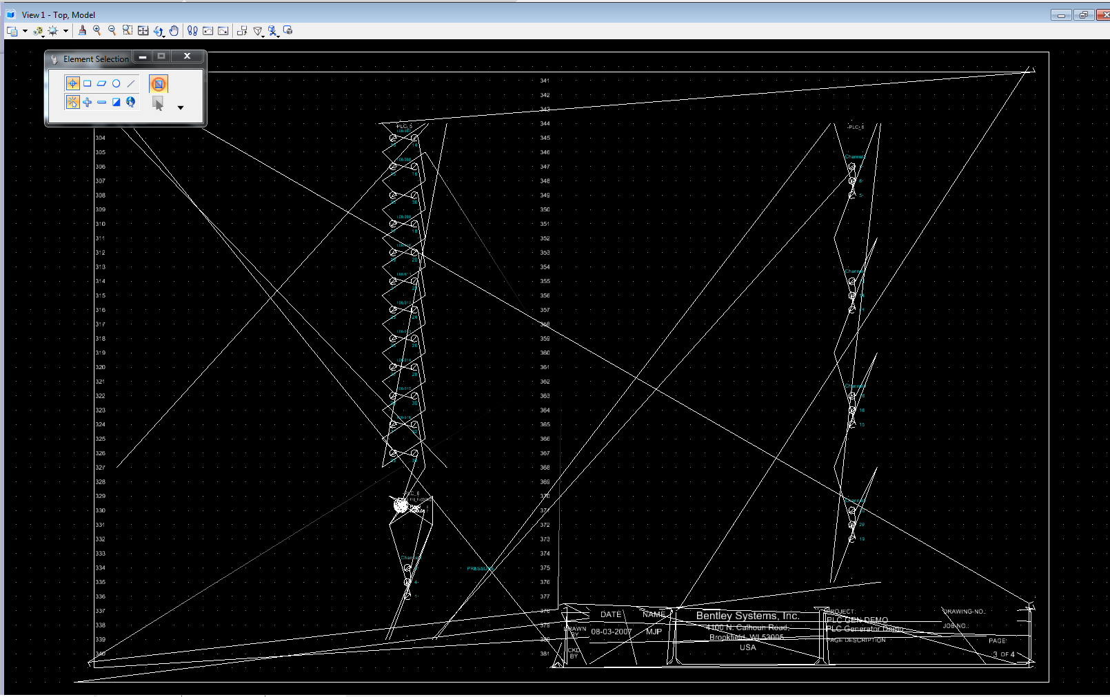

Random, distorted, or extra lines appear on every DGN file
Product(s):Promis.e, Bentley Substation
Version(s):through 08.11.12.137
Environment:N\A
Area:Installation_Configuration
Subarea:N\A
Problem Description
When any project page is opened, for any project including sample projects, the drawing appears corrupted with extra, random lines appearing. The problem often does not occur opening the same pages on other workstations.
Explanation
This is purely a display issue. Nothing is wrong or getting corrupted with the DGN file or data. This is an issue with the graphics card driver.
