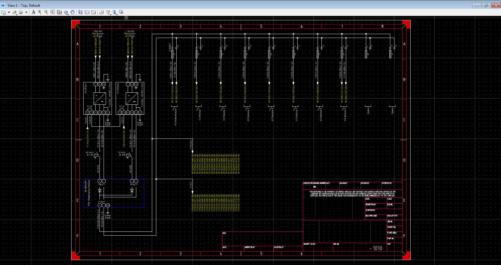

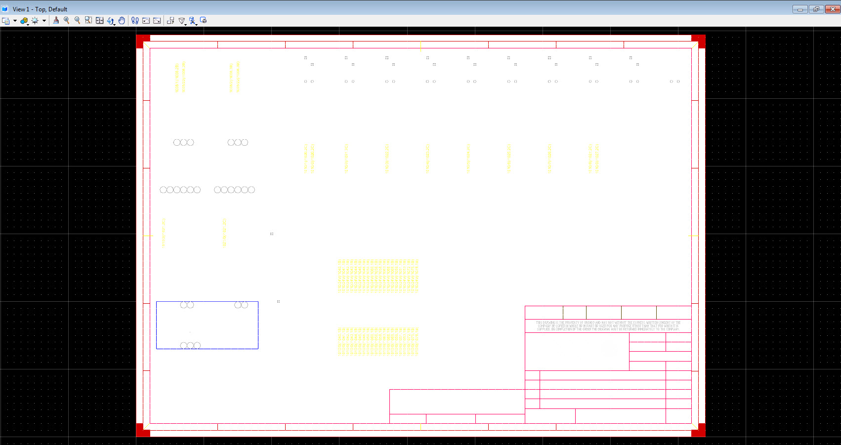

Area inside the drawing border has become white or Drawings appear against a white background as shown below.
Explanation

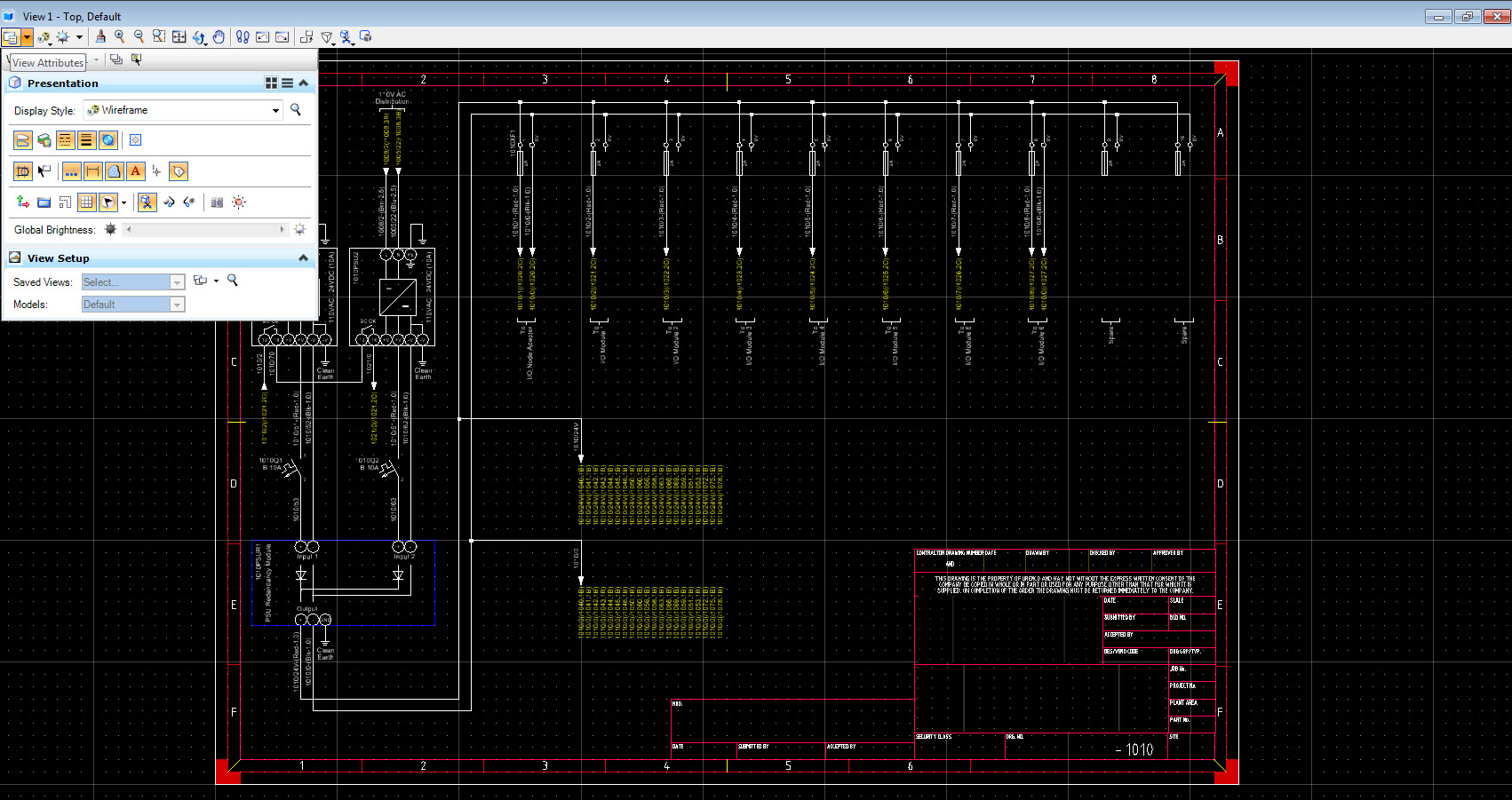

When the display style is changed from Wireframe to one that is not appropriate for 2D drawings, the drawing can appear filled with white. To go back to default display, the Wireframe display style should be selected.
Steps to Resolve
Go to the View Attributes section of the view and select the Wireframe display style. Refer the screen shot below.
