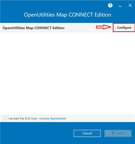

2. The Bentley OpenUtilities Map CONNECT Edition Installation Wizard opens to the screen below:
3. Select the ‘Configure’ icon on the top right of the dialog

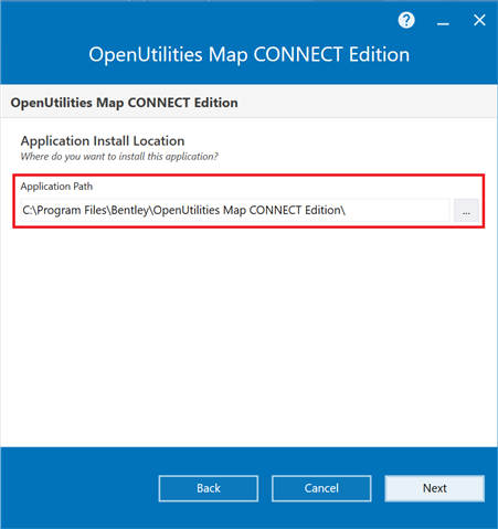

4. On this page, you will be able to tell the Installation Wizard where you want the application to be installed. By default, the application is installed in the following directory: C:\Program Files\Bentley\OpenUtilities Map CONNECT Edition\
5. Click the ‘Next’ icon.

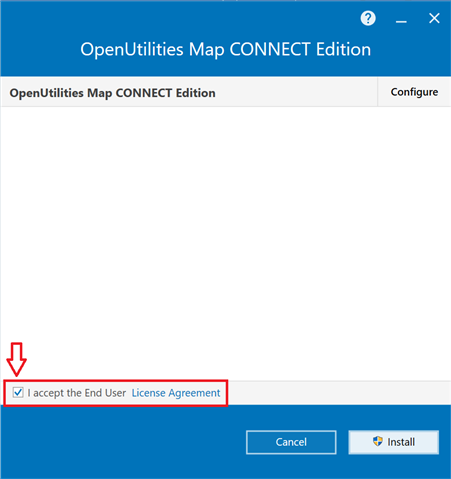

10. Click ‘Done’ and you will be taken back to the first page of the Installation Wizard. On this page, check ‘I accept the End User License Agreement’ in the bottom left corner of the dialog. You must accept the License Agreement to move forward. This action will activate the ‘Install’ icon.

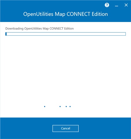

11. Click the ‘Install’ icon. The installation will begin and you will see a couple of different status bars. The first status bar will show 'Downloading OpenUtilities Map CONNECT Edition'. The second status bar will show 'Installing OpenUtilities Map CONNECT Edition. Once both of these status bars are complete, the Bentley OpenUtilities Map product will be installed on the machine.
12. Click the 'Finish' icon at the completion of the product installation.
